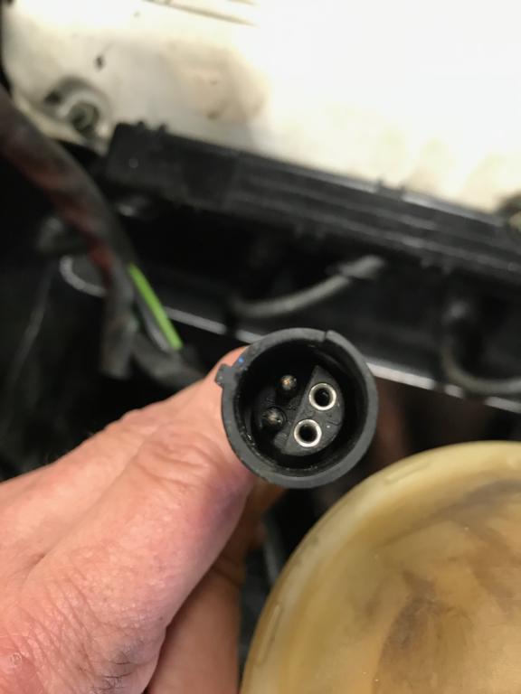

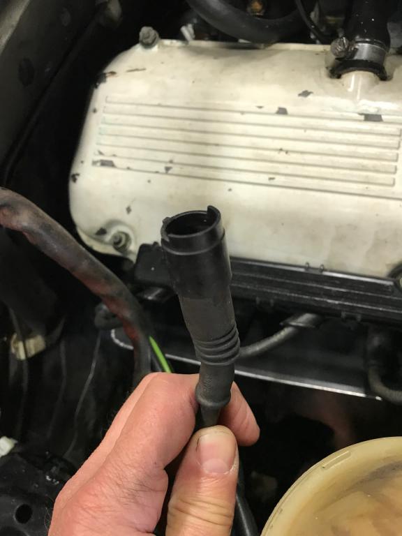

    I just finished a 325E to 325I swap on a 1987 and I ran into a problem with the 02 sensor. The "E" used a 3 pin and the "I" uses a 4 pin. I'm looking for the short cable the goes from the mail wiring harness to the 02 sensor. it connects to the harness at the passenger side strut tower. it uses a 4 pin plug connecter ( pre 9/87) as opposed to the more common screw on type of connector. here are a couple of pics of the connection on the wiring harness. both the E and the I harness and engine are from a 1987. If you have one or know where I can find one please let me know.
    THANKS!

    i ran into this problem and i bought mine from rock auto a few years back. i bought a denso sensor, fits and works great also comes with a copper lubricant for the threads. just look up 1987 325is on rock auto in the exhaust and emissions category

      thanks for the suggestion. they had one with a 25.5" harness which might be long enough. i ordered one to give it a try.

            if you are using the 325i exhaust headers the sensor should be in the bay, unlike the 325e exhaust has the o2 bung a little more back by the cat which needs a wire extension. thats what i remember from when i did my car. the o2 sensor i mentioned is pretty long.
