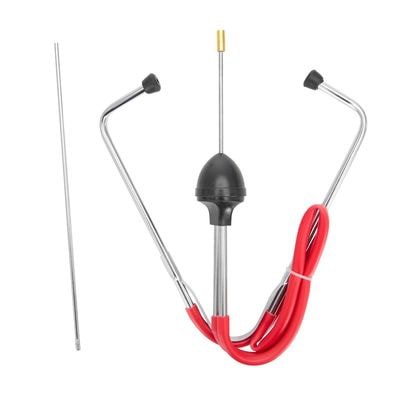

        How certain that it's coming from the motor? $10 from the local auto store will help to pinpoint the exact area

          I tried listening at the oil cap and listening at the dipstick and neither sounded louder. Its the loudest inside, at the feet, right about where the bell housing and back of the engine meet. As long as I'm within those RPM coming from idle, it will knock. If I bring the RPM past the knocking, to lets say 3.5k and then gradually back down to the knocking range, it will be gone. But once I let it go to idle and raise it to that point again, it reappears. Pushing in the clutch does nothing to stop the sound.
