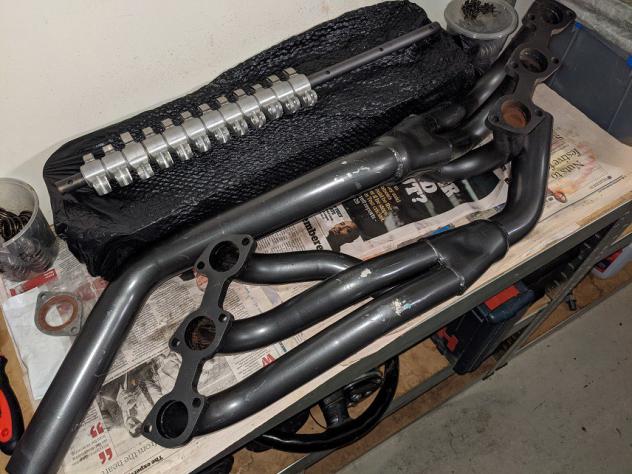

                  I may revisit RHDs ITB kit. Currently sat in a box in the garage. Ran out of time during my first install attempt. A combination of product issues (that Rama was prompt to address) and a noisy TPS when I finally got it all balanced meant I shelved the idea. My E30 isn't a DD, but from memory the car had been off the road for 4 weeks. The noisy TPS was almost certainly a grounding issue with either the TPS or my Megasquirt. I have a P&G TPS somewhere that I was going to try...
                  On the other side, I've had these sat on a different shelf for a couple years now:
                  Click image for larger version  Name:	exh.jpg Views:	0 Size:	58.2 KB ID:	10034325
                  I know you've done a fair bit of testing wrt different exhaust configurations and their respective performance gains/losses. I'm interested to hear your thoughts! :)

                      Dug out the email. I bought them in 2016. Sold on ebay by "ems-europeanmotorsports" in Wiley Park NSW. Advertised as "direct copies from a genuine set of hartge H23/H26 headers". Seemed like a better quality alternative to some of the dodgy "ebay headers" available at the time.
                      The original ebay ad is NLA. Found a link with the details:
                      Brand New Bmw RHD E30 M20 320i 323i 325i 325is Hartge Alpina Extractors Headers. BMW E30 M20 extractors/headers, these are direct copies from a genuine set of hartge H23/H26 headers. They're made from highest quality steel and are sold with 12 months warranty, ceramic coating also available, ports are matched to standard 731/885 head. Piping from flange to collector is 1.5inch and 2 in from collector. No fabrication to extractors needed, direct factory fit RIGHT HAND DRIVE, beware of poor quality copies. Please call Warren on 0420 206 206 for more info. We also supply headers for most M30 vehicles (E28/E24) We can source most parts, email us today with an enquiry Condition: Brand New, Returns Accepted: ReturnsNotAccepted, Modified Item: No, Custom Bundle: No,

                        I remember seeing them on eBay. Can’t be worse than factory iron stuff unless they don’t fit

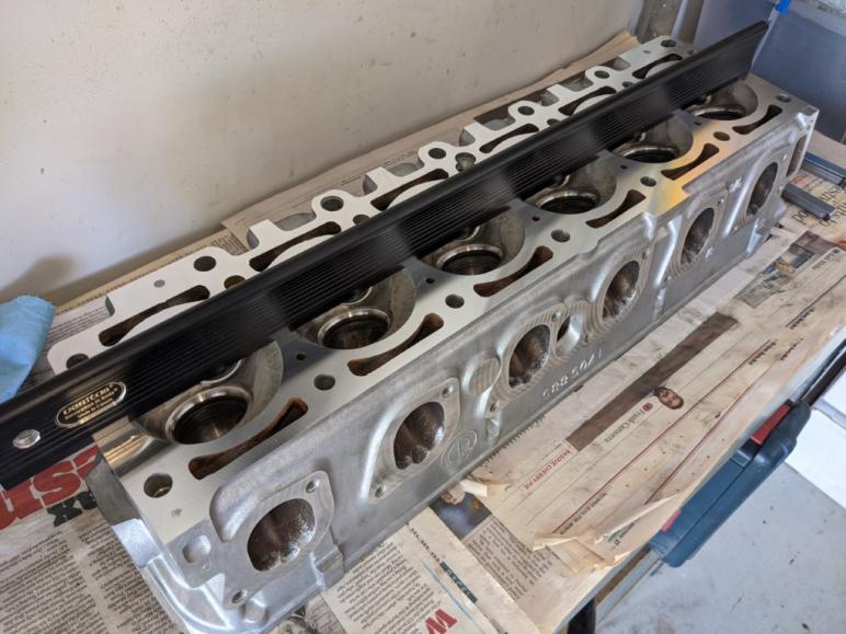

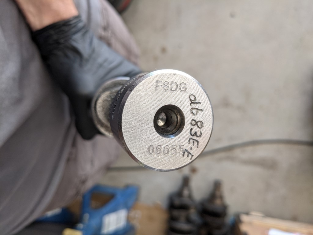

                          Cleaned the head today and installed the dbilas 284/284. I wanted to make enough progress to measure the duration numbers, for comparison.
                          Click image for larger version  Name:	flat.jpg Views:	0 Size:	70.6 KB ID:	10034974
                          Actually bothering to check this time...
                          Click image for larger version  Name:	stamp.jpg Views:	0 Size:	100.0 KB ID:	10034975

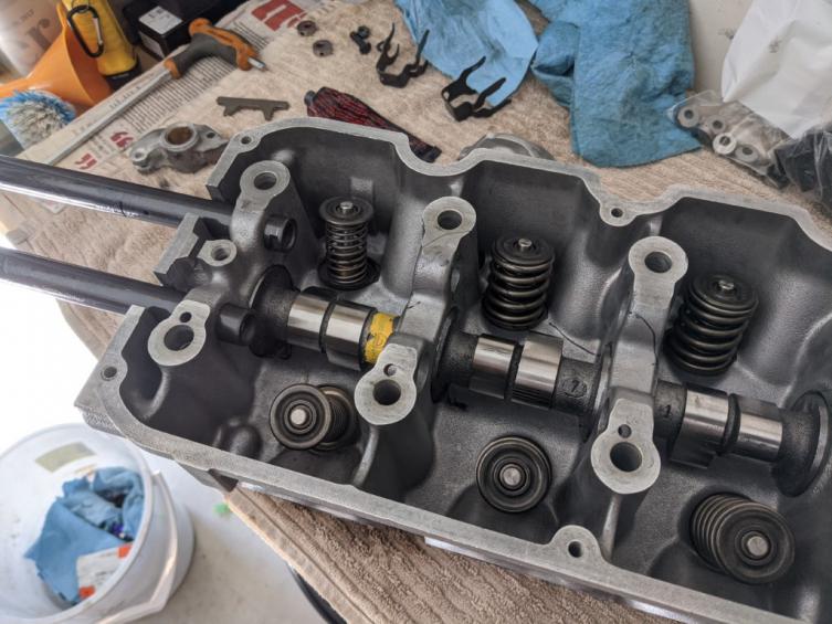

                          Discovered the end plugs on the Genuine BMW rocker shafts thread in far enough to really recess the plug. When tightened all the way in (like in the picture), the inside face of the plug sits flush with the side of the oil feed hole(s).
                          I haven't made a decision on which way to install the plugs - tighten them down like in the picture, or back them out so they're flush with the end of the shaft. In both cases I'll likely need to use a thread locker/sealant. Unsure which yet..
                          Click image for larger version  Name:	recess.jpg Views:	0 Size:	41.4 KB ID:	10034976
                          I can see how having the plugs all the way in would prevent a static "pool" of oil from sitting in end of the shafts:
                          Click image for larger version  Name:	flow.png Views:	0 Size:	1.2 KB ID:	10034977
                          On a related note, check your shafts for debris! Couple of the holes had some nice shards of metal hanging off them from manufacturing.

                              I'd certainly like to. Only hurdle is getting a handle on what to install.
                              Based on your comments from 2014, it sounds like some careful considerations need to be factored in - eg, cross pipe location.
                              Right now all I have is the stock exhaust manifold, a couple of offset hi-flow cats and a Remus cat-back. I stupidly installed the hi-flow cats with very little forethought (something I've become quite adept at... )
                              And of course those Hartge H23/H26 headers sitting on the shelf. Assuming they're not a terrible option, I'll be most likely using them as the basis for whatever gets installed.
                              Need to spend some time documenting a plan for the exhaust...suggestions welcome.

                                6-2-x-twin pipe or if your muffler is a single 6-2-y-single
                                twin 2" is fine, single 2.5" is also fine
                                X or Y around the fuel tank area if you want to boost torque in the 2000-3000 rpm range otherwise just behind gearbox
                                generic metal cats
                                a small muffler as resonator works better than hot dogs
                                muffler with biggest volume that fits
