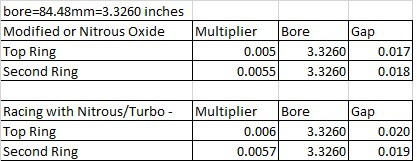

    The machine shop I used didn't return the documentation that came with my Mahle oversized pistons(84.48mm) below is their response when I contacted Mahle but it really doesn't seem right to me. Is what they are saying correct? And second question for a turbo application should I open up the gaps?

    They actually should be a little over gapped out of the box based on my experience. If you are going to be turbo/SC/nitrous, then open the gaps according to this literature:
    Gaps on the big side are safer than the tight side. Ideally the rings should almost close (but not touch) at operating temps - hence the gaps when room temp.
      No worries. I am going back and forth between the Racing with Nitrous/Turbo or Modified/Nitrous. I think based on my reading I will be better off going with the bigger gaps even though it will be a street car.

        I found the Mahle sheet and it has 0.006 as the multiplier on both. I am going with 0.020 gap on both both rings
