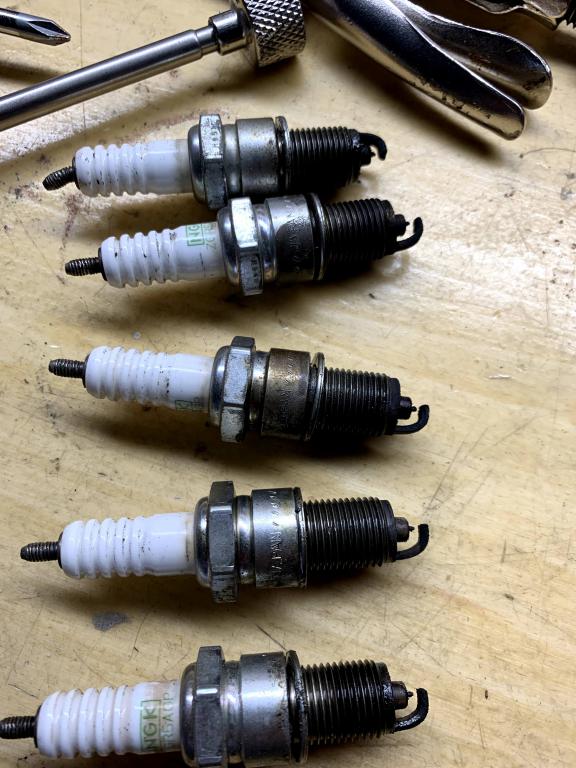

          Hi everyone apologies for being non-responsive. I have a parallel thread going over at bmw2002faq.com which as become quite active. Short summary looks like a couple issues. Poor spark, and poorly seated pistons causing low pressure across all cyls and/or bad cylinder head gasket.
          At any rate it looks like I've got a couple issues going on.
          Issue #1 Rough idle as mentioned in this post.
          I pulled all my spark plugs and they are BLACK. Possibly due to the engine running real rich. I bought the motor rebuilt back in 2013 and I'm just now getting it to fire in my 2002. I don't know if the plugs are black due to the many attempts of trying to get the engine to fire. At any rate, I have all new plugs, new spark plug wires since the old ones were not looking good and a new rotor and cap. Terminals on cap were cracked.

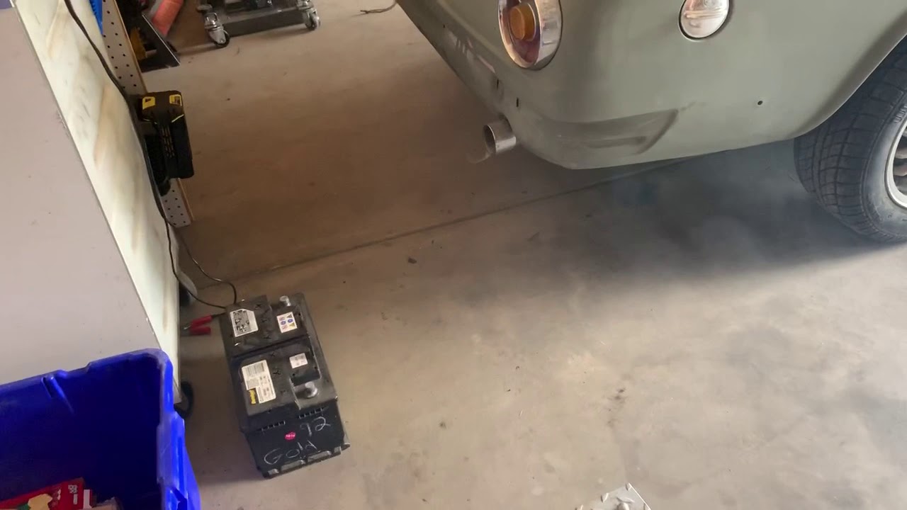

          When I pulled the compression tester out after doing the wet compression test, I found milky oil in the tester hose. Also, I believe the smoke to be coming out the back of the car is white. I thought maybe it was a blue gray. I may be colored blind -I don't usually believe my wife.
          Video of the smoke coming out of the tailpipe. Smoke is present immediately upon running.
