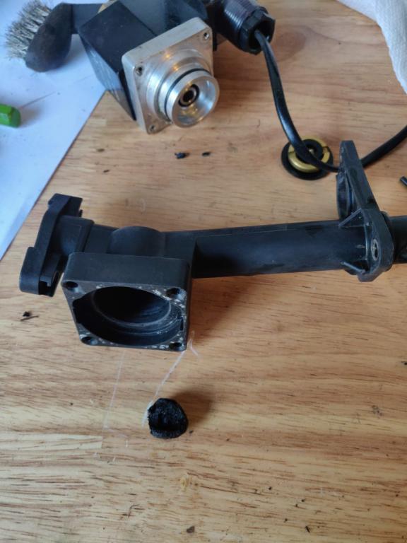

                      Figured it out - dug that plastic plug out of the heater valve pipe, right by the elbow coming from the heater core.
                        So. stuck solenoid after all?
                        If you have A/C, deleting that may cause some issues.
                        • Chebyshev
                          • Aug 2007
                          • 50
                          No, the solenoid is fine, I bench tested it. The pipe leading to it was clogged. I'm not deleting anything, I just dug out that clog with a screwdriver and reinstalled everything.
                          • JehTehsus
                            • Dec 2019
                            • 269
                            Ahh, I see, thought that was a piece of the solenoid. Where did a plastic chunk that size get into the system from?
                            • Chebyshev
                              • Aug 2007
                              • 50
                              Yeah, I wonder about that too. I don't know the full history of the engine unfortunately, so I can only guess. My guess is that at some point something plastic got shredded up (crappy water pump impeller maybe?) and the little shards of plastic built up in that spot and melted together in the heat and pressure of the coolant over time, forming that plastic chunk. It didn't have a defined shape, but rather was formed to the inside of the pipe.
