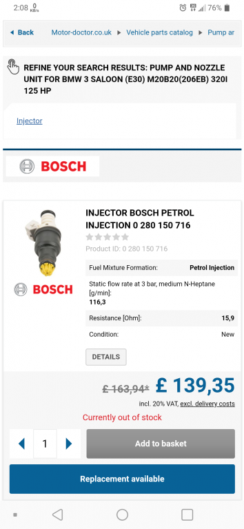

          0280150716

              How come!? Same set is installed in my 320i Bosch met. V1.3 for years with no problems.
              As per the pic below they are high impedance mine test 15-16 Ω.

                if they are low impedance then fine, when i searched somehow they appeared to be low impedance. can just measure rsistance across pin to confirm

                  I confirm they are 15-16 Ω but am i ok running them in b25 at 2.5bar regulator from b20?

                    116 g/min = ~116*60/1000*2.204 = 15 lb/hr
                    SQRT(2.5/3.0) = 0.91
                    so flow will be 0.91*15.3 = 14 lb/hr so its only 7% less than stock
                    should run ok with O2 sensor feedback with the ECU is functioning correctly and engine is stock, if you can get 3b regulator there will be less corrections going on wihtin the ECU.
