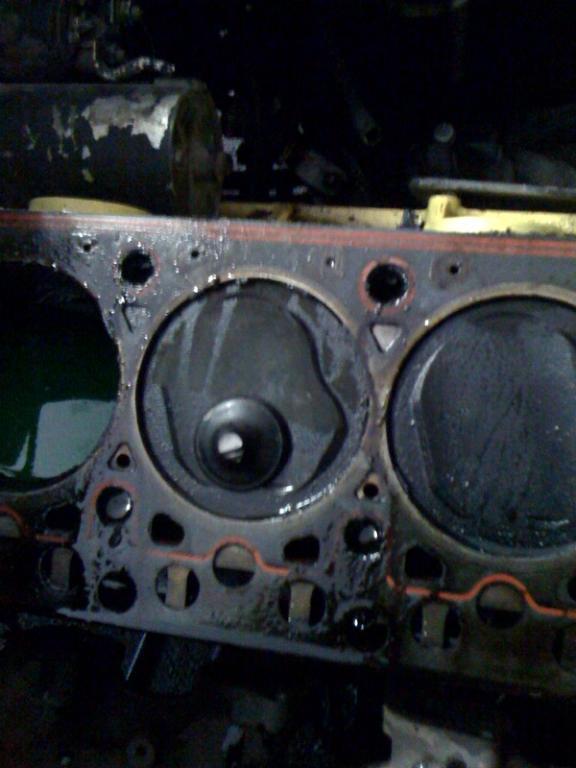

    Broke a rocker arm and finally got to pulling the head today. Parts car should be coming early this week and, depending on how long the machine shop takes, should be up and running by the end of the week. The piston is fine BTW.

        ha, I'm actually surprised it didn't do any damage now that I think about it. Usually a snapped valve will destroy a motor. Maybe because it was at 1k rpm and died right away after it happened.

              Cam gear bolts snapped off and let the cam freewheel. Stuck 4 valves about a quarter inch into the pistons :(

                wow thats intense. I don't even know how mine happened. I'm thinking the rod was bent a little in the first place and it progressively got worse.
