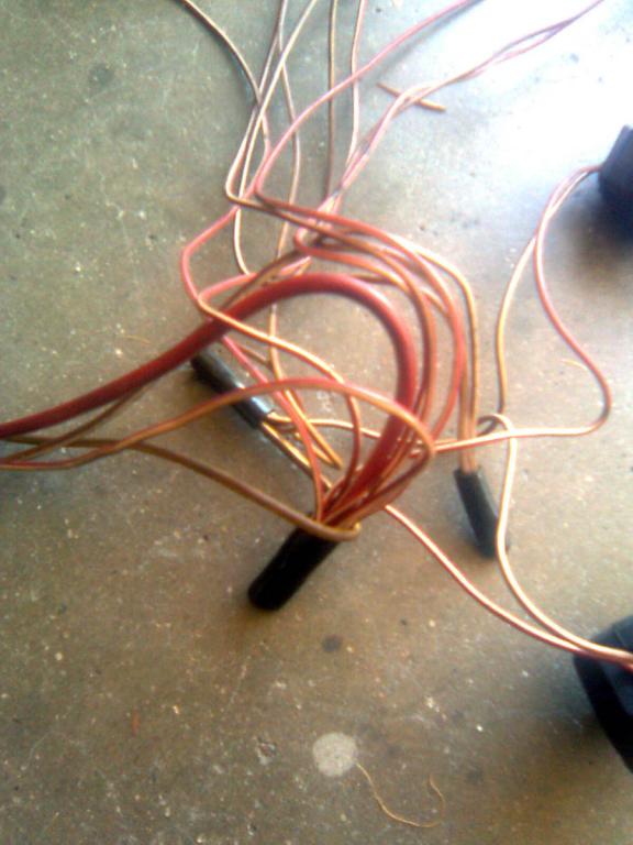

    As I was cleaning up a wiring harness, I noticed that the injector ends of the wiring harness are connected to 3 main wires, are the injectors fired as 3 pairs of 2s?

    No, two pairs of 3
    135, 264
    one wire is power that goes to all 6, the other two wires are grounds that are switched at the ECU

      Thanks, I thought I remember they were paired, but when I looked at the harness I wanted to make sure. I am trying to clean it up, maybe I'll cut injector end and add an adapter for ease of installation...
      With 2 pairs, it will be easier to figure out which ends go to 135 and 264..
