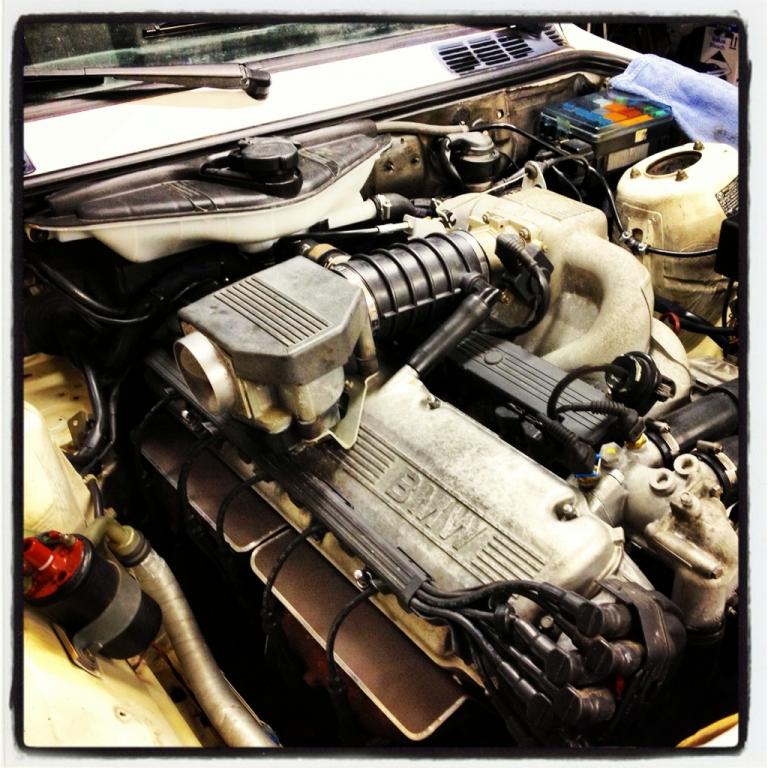

                Almost ready to start up for first time. It's a very low mileage m30b35 so I didn't mess with cleaning up any of the finishes. I like the aged aluminum.
                Coupled to an 4hp22 just for grins and traffic.

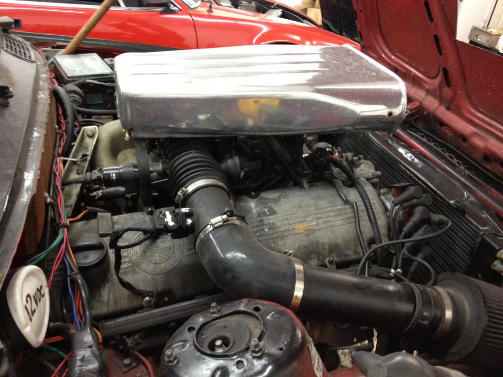

                        Yes - I know the bay looks like crap but we have to keep it that way for Lemons and Chumps. Yes - I know it's a b34 (had 4 laying around the shop) but what you don't see is a new fully ported head, b35 cam, complete engine rebuild, scraper/windage tray, Miller War Chip and MAF.
                        When the car was on the dyno we used the factory m20 air box after the 4 pull we finally saw the intake hose collapsing so we upped to a larger K/N cone - much better results.
                        The theme is Max Mad so that's why the blower scoop
