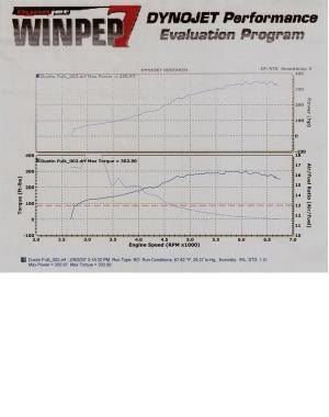

        its super hard to read that, but it was 350.97 hp and 302.90 tq
        so, yes I have, that was a low boost, pump gas run, 23psi I went on to run 110 with a bigger tb and sheet metal intake along with 32psi to make 442whp and that was a 100% street car just for fun,
        that is why I like the 4g63, but honestly the sr20 is looking like a better solution. I have however found plenty of rwd solutions for the 4g motor
