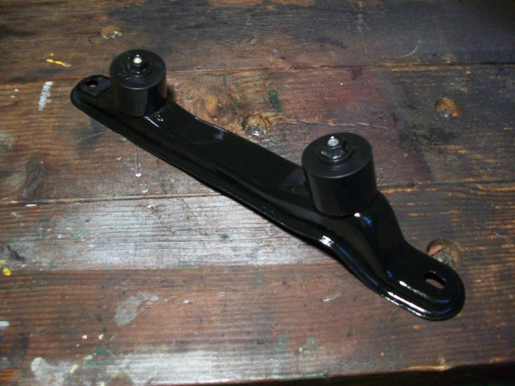

            I have AKG all around for my swap. looking forward to see how they perform once the car is up and running.
