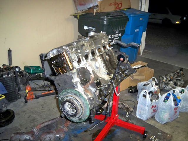

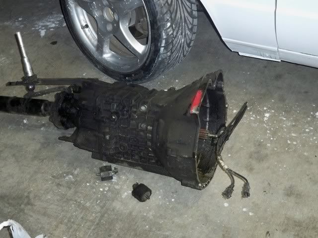

    Well I guess to start, I got a 3.4 M30 out of a 87 535is. I also got the wiring harness, e28 radiator, and the transmission out of the same car. From what I could find it should be the 260.
    Here's a couple pics of the engine and trans when I was cleanin up for the night.

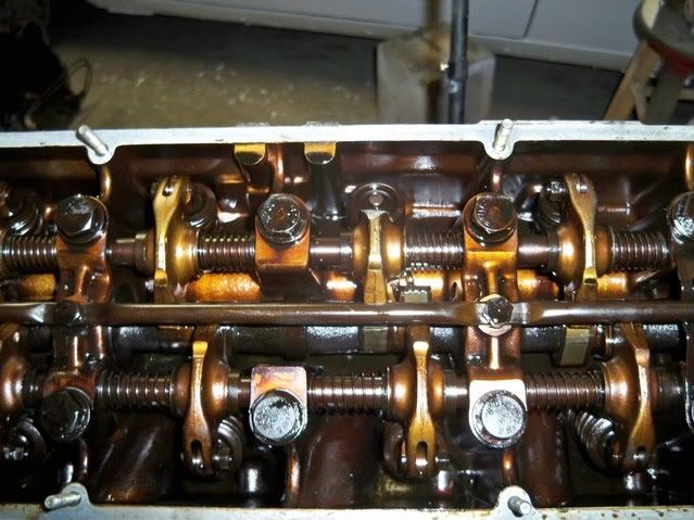

    When breaking down the motor for inspection I found this...

    I believe that may be all I need. Oh and when I was first gonna do the swap I was gonna use my 240 transmission, now that I have this one which driveshaft do I need?

      If your car is a 7/86 to 6/87 production date, you can use the driveshaft you have with no mods with the E28 trans.

        That's too bad, I have an '85. I was looking around and read that people have used the front of a 535 driveshaft and the rear of an e30 driveshaft. Is that for all e30s or just the ones with a m20?

          That's actually not too uncommon. Just get all new rockers. The new ones are stronger than the old. Also, while I had the rockers out, I'd take out the cam and at least throw in a B35 cam. Slightly more aggressive. Or go all out and get a nice Schrick.

              don't valves usually bend too?

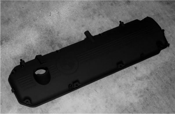

                        Started cleaning up the engine a bit starting with the valve cover. Didn't get a before picture, but it was pretty dirty. Here's after paint.
                        Going to be sanding the raised emblem, keeping the stripes painted.

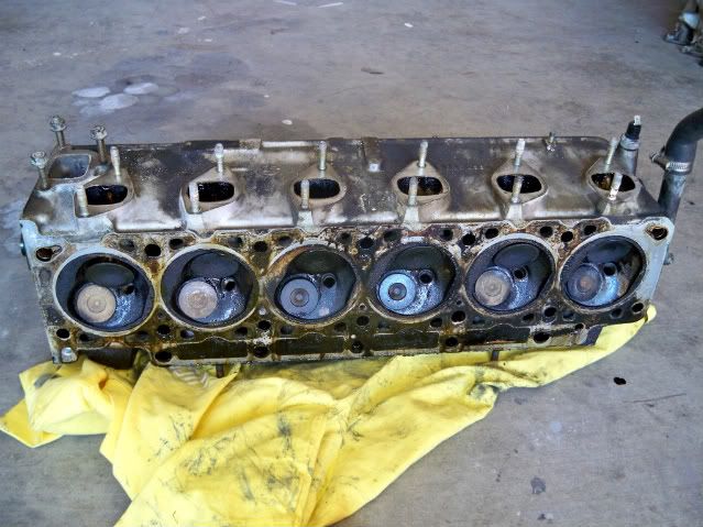

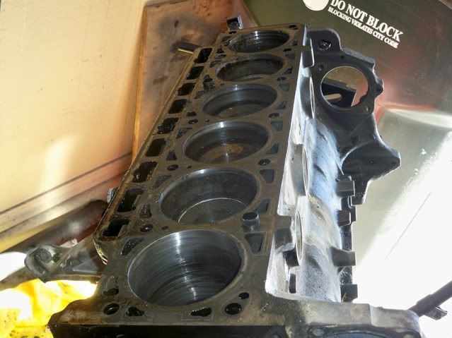

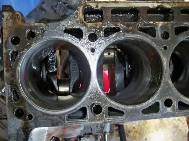

                          Got the socket so I could take the crank nut off, in turn was able to take the head off and all the pistons out. Actually looks pretty decent, a lot better than I had in my head. I'll post up some pics when I get back from work.
                          • thirdirev
                            • 101
                            Now for some pictures...
                            Most of the cylinders looked the same, #2 was probably the worst.
                            Hopefully get it all cleaned and start assembling next week.
