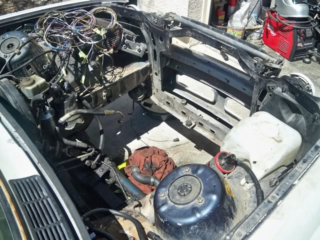

    Well after a couple hours of tugging, unbolting the exhaust manifold, and finding out there was a shock absorber attached to the passenger motor mount; the M10 is finally out. Waiting on some mounts from Qbang, electric fan from Summit, thermostat housing and rotor from Pelican Parts, and the M30 should be good to go in. Gonna get all my electrical wiring done tomorrow on my day off.
    Didn't get a before pic, but here's my empty bay.
    Did a little bit of wiping on the rack and subframe, finishing that tomorrow as well.

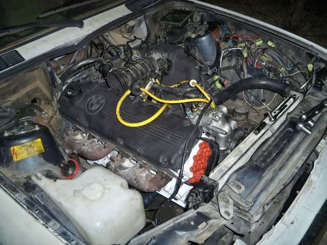

                    Well here's some pics of how it sits tonight. I know it's a bit messy, still trying to get the wiring done and waiting on injectors. Might have some wiring questions later this week. After today, being off, I won't get another one til next week sometime.

                      #55
                      Nearly there!
                      Nice work.
