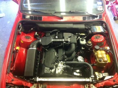

    So I wrapped up yesterday and it fired up in about 10 sec. Idle's good, charging good, oil pressure good. Loud as hell with open pipes.
    Needless to say I was impressed! First try. Then slapped in. The 3.46 LSD. The moved to the drive shaft.
    This is where the error occurred. Have 325e front half, my 318i rear half. The dam thing is to long!!!!
    I am using position 3. Now I have to have to driveshaft shortened and balanced. Nickel and dimed I tell you!!
    Might just have the whole thing rebuilt and be done with it.
    Here is a link to the startup video. Crappy I know. I was just to excited to care...
    Thanks
    Kris

            Clean swap! Looks beautiful under there.

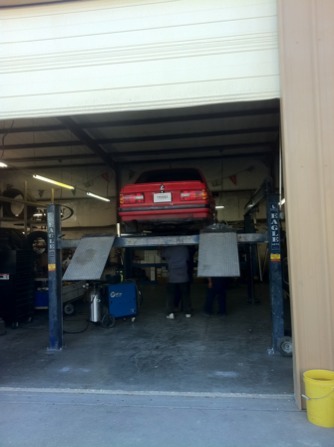

              I went ahead and took it in. The rear u-joint on mine was shot. They are going to rebuild it with serviceable u-joints and shorten it so it will be good as new. Should be done Friday. Add tranny fluid and diff fliud and should be good to go.

                Swap looks great, we need more pics when it's totally wrapped up! Looks like you have some decent distributor cap to radiator clearance, eh? Just to double check, was your 325e front half from a stick shift car?

                    Driveshaft picked up, will install tonight and drive around. Hopefully tomorrow exhaust, then inspection.

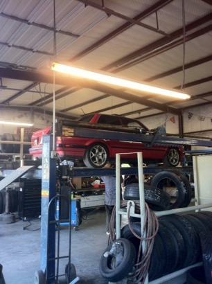

                            So I started trouble shooting it on Sat. Found out that cylinder one was not working. Checked plug wire, they were new so I did not suspect anything. Tried an old plug wire, still nothing. Tried new plug, did nothing compression check was 175.
                            It was the freaking injector plug not seated. Pushed it in and made a world of diff. Now it's nice and smooth. Have to take care of the heat issue. Bigger better fan I think. Oh and lots of bleeding.
                            Here it is now. Getting exhaust put on. Pick it up tonight after wk.
