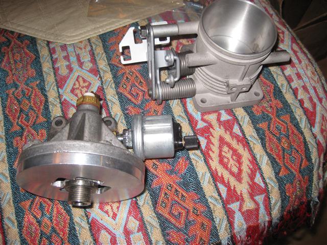

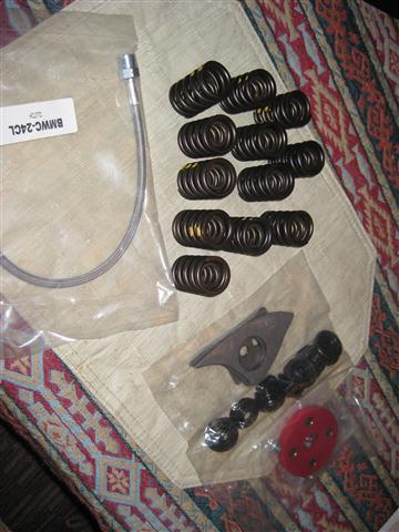

            So, not a lot of progress, but I got some things going to the machine shop over the next couple weeks, and some of the parts are rolling in. Got my kobelschmidt rod and main bearings, picking up the deves swedish steel rings tomorrow at the local german auto shop, my black friday sale haul from Ireland arrived (dual valve springs, retainers, stainless clutch line, steering rack guibo, front subframe weld plates), as well as the ultra-trick goodies from Milos - a overbored throttle body, and spin on oil filter adapter with vdo sending units for the gauges.
            It's like christmas!
