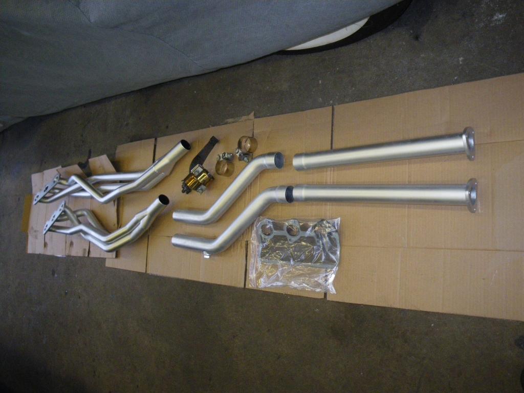

                  I finally picked up a set of used Bavauto headers. I have not mounted them yet but it looks like they will easily clear my Otis designed B35 motor mounts and also clear the stock CAB. I will have to do some extra mashing of the floor area under the glove box near the trans tunnel and may need to grind off a casting protrusion on the back of the engine block but things look promising. These look like the best option. This spring I will retune after installing these and a BBTB from Maxbore.

                      Some pics of Bavauto headers that only require pushing in the foot well area a bit and grinding down a block protrusion about an inch. I didn't use the rear most sections because I Y piped them into a single 2 1/2" resonator and then a 2 1/2" turbo muffler.
                      Plenty of clearance at the CAB
                      ...and clearance at the engine mounts
                      My finger is pointing at what I ground down.
                      I like this view.
