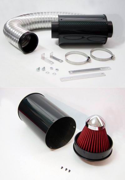

          I'm using Schrick 288...bad idle good top speed... Since you are looking for Cone filter w/ heatshield why not try this Cool air intake
