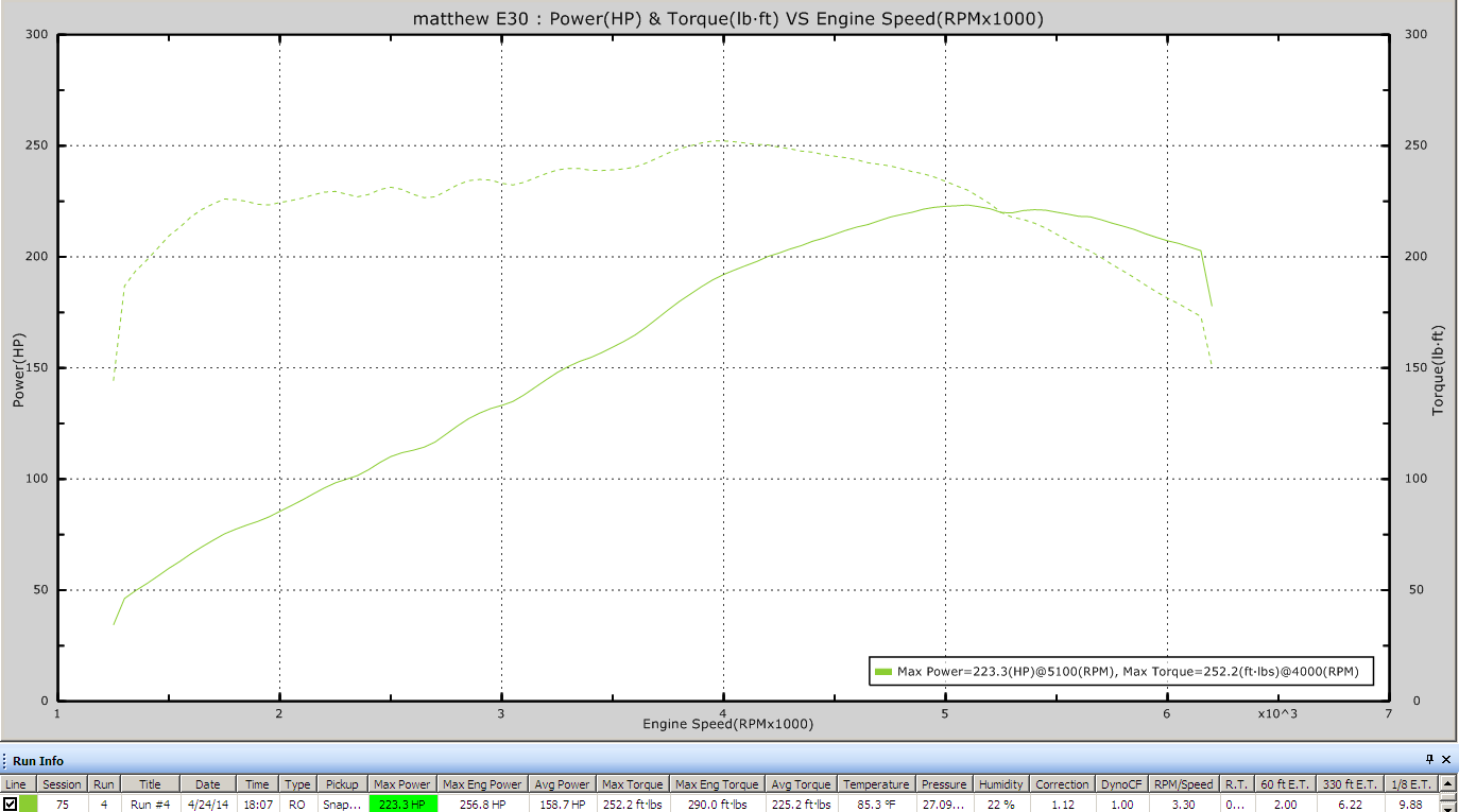

      So the car now has right at 2k miles on the swap. The Megasquirt has been dialed in and all systems are running smoothly. Therefore it is time for the Turbo to be installed. BUT first I wanted to see what all this effort netted me on the NA engine since it runs so freaking well.
      Keep in mind that this engine is a hybrid B34/B35 and it the compression has been reduced to 8.6:1 for the future turbo. But the displacement is at 3573cc at this point. The car made 223 whp and 252 wtq SAE at 5100rpm on a Dynocom.
      Without further ado....

        Nice #'s , how does that dyno compare to dynojet #'s?
        Lorin
        The M30 is God's engine.
          Supposedly within 3%
          I had an option to go to a dynojet with a less experienced tuner, a mustang dyno, or this one with a very reputable tuner. Even though he didn't have to change the tune much other than taking a couple degrees out of the timing, I went with him because I want experience on my side when positive manifold pressure goes into effect.

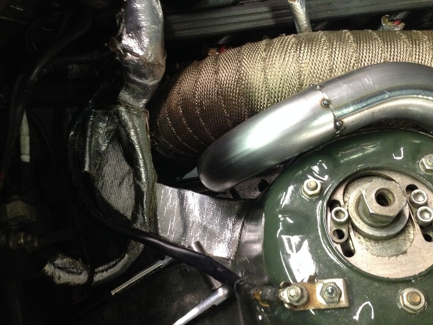

                    Positive manifold pressure is within sight!

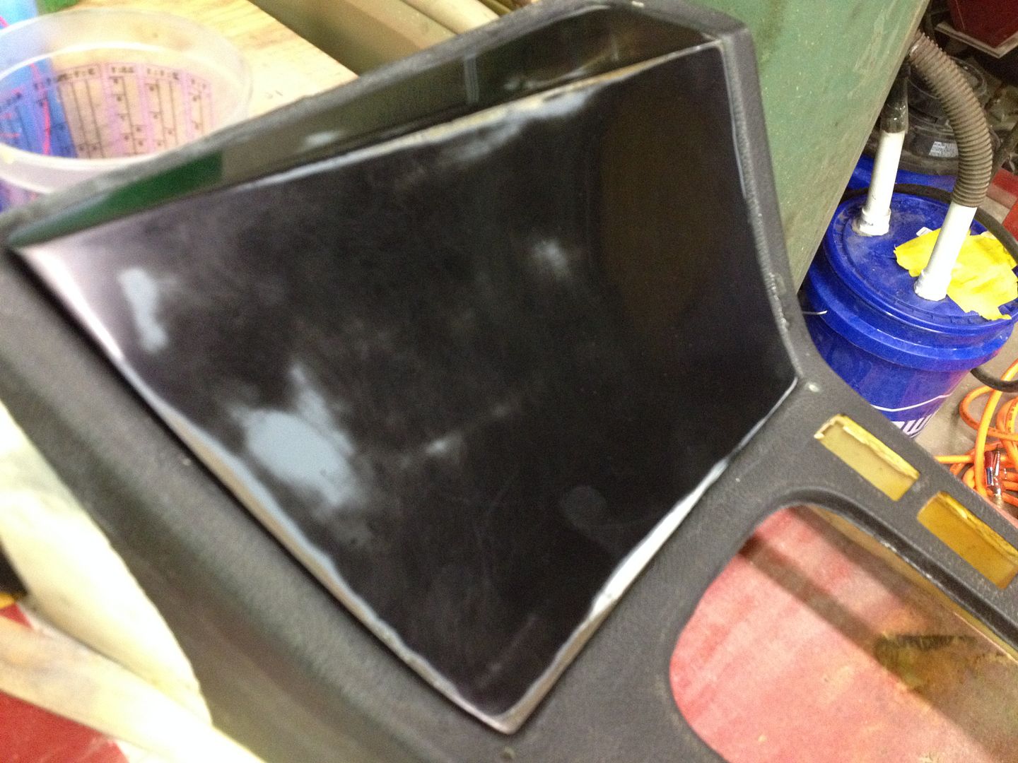

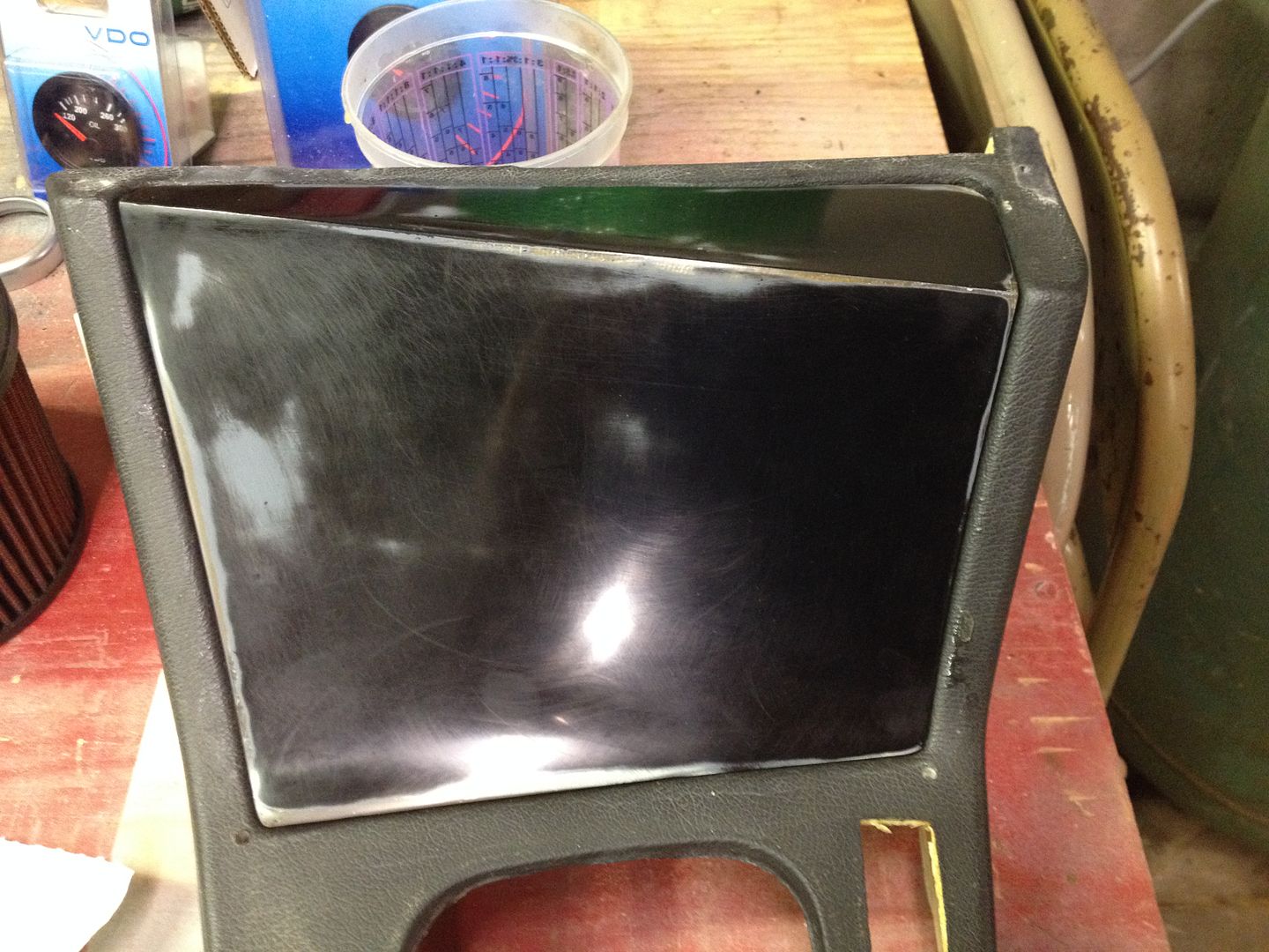

                    Today I got in my piping for the wastegate and started the process of plumbing it in. I also had some oil lines made so I can get oil to and away from the turbo.

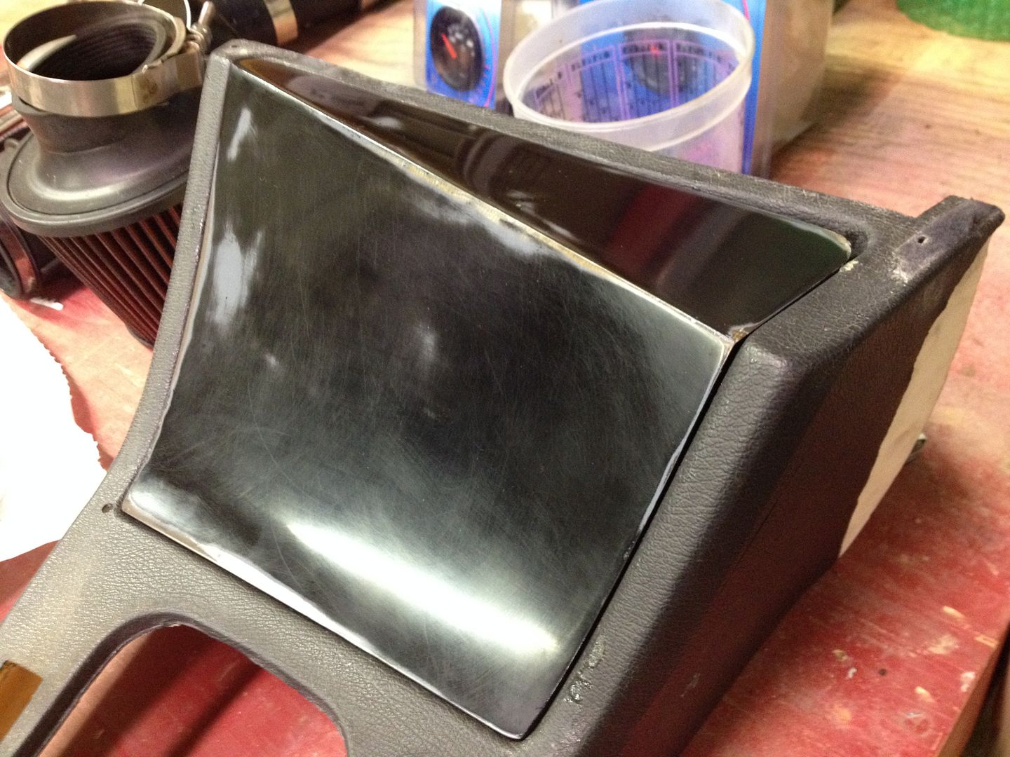

                    I also have skipped posting a few steps showing progress on the gauge plate but here is the nearly finished part. Keep in mind there will be 3 gauges across the top and other items on the bottom half. I am considering making these for the community, let me know if any of you would be remotely interested.

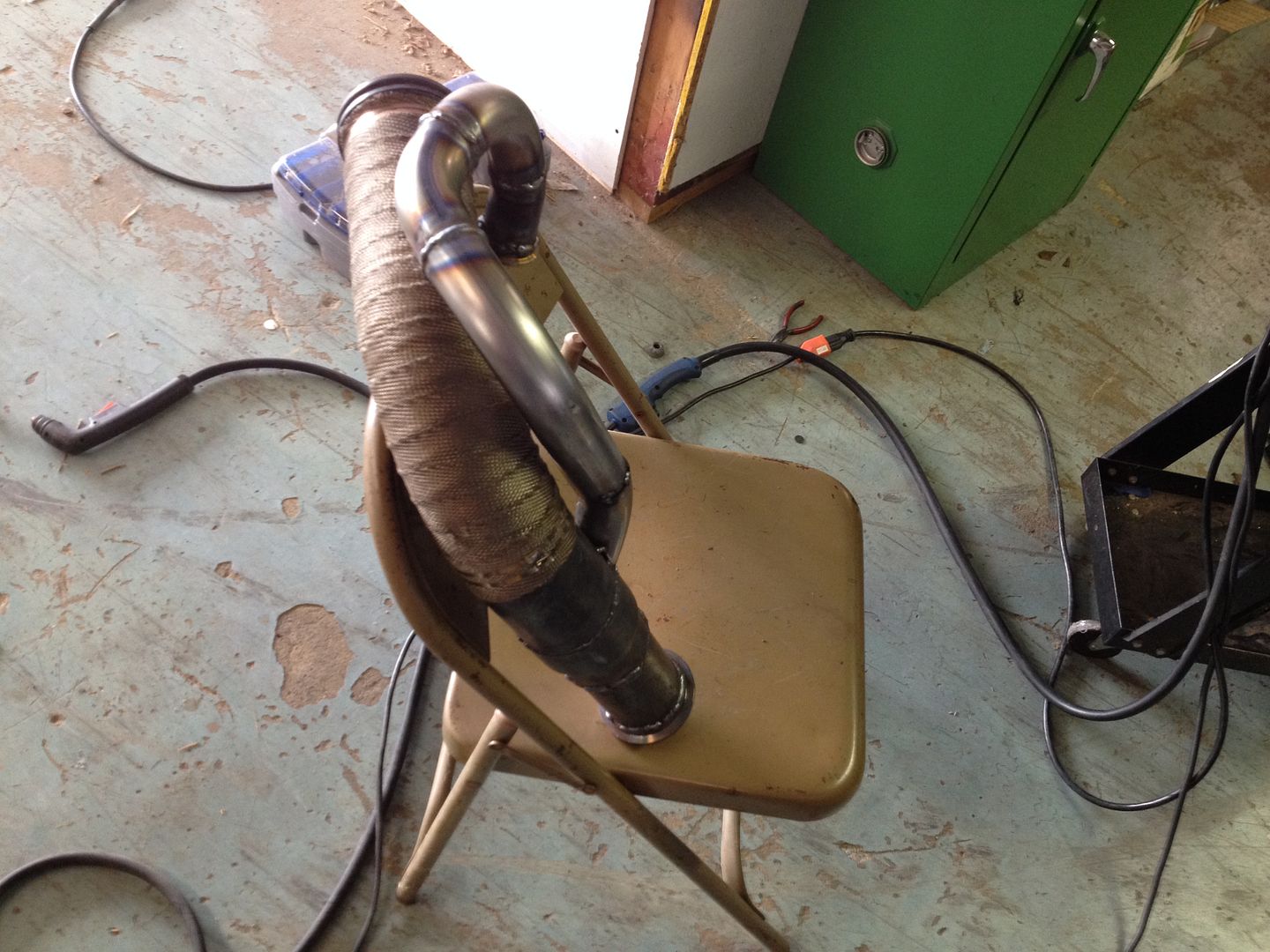

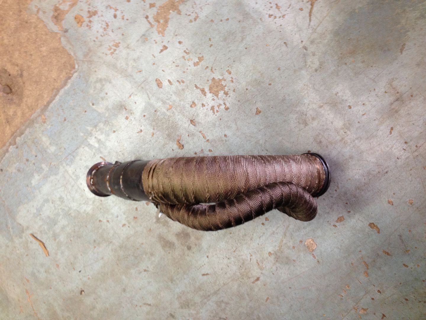

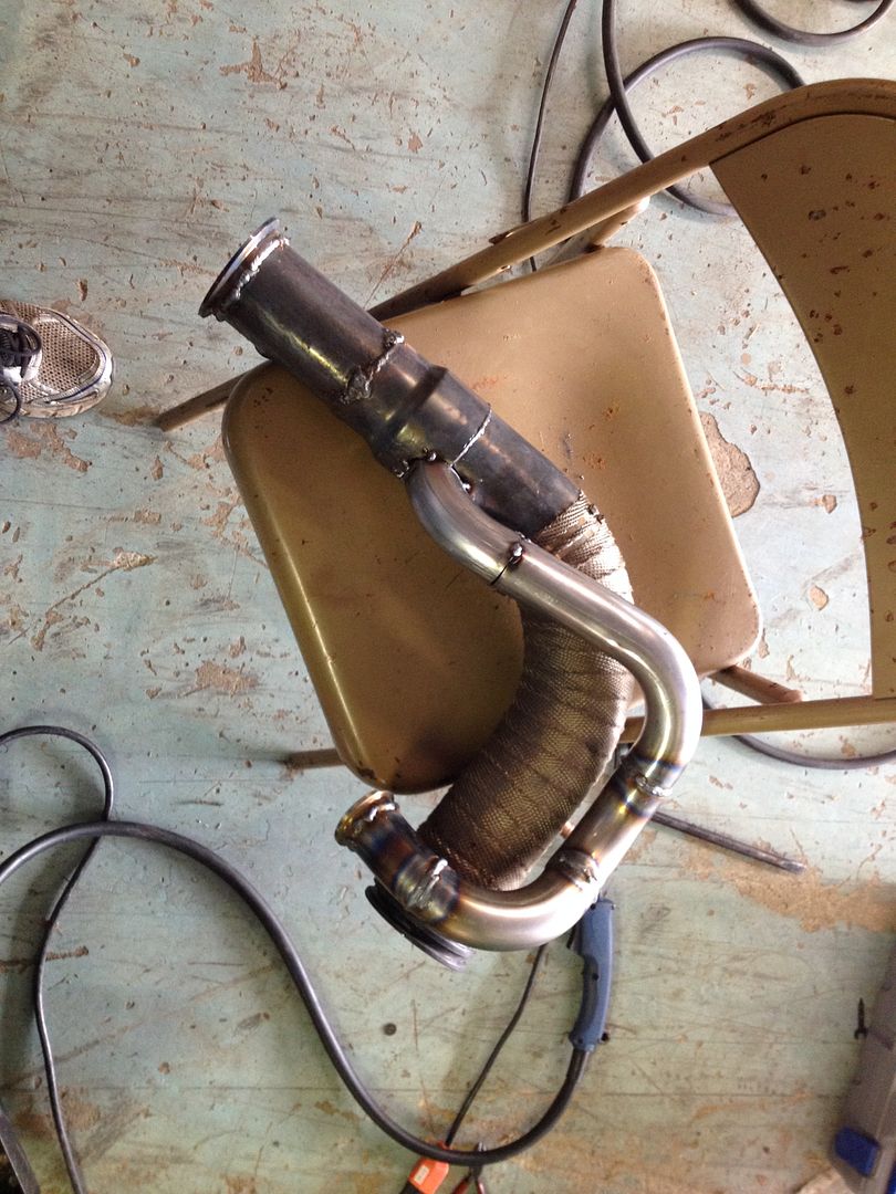

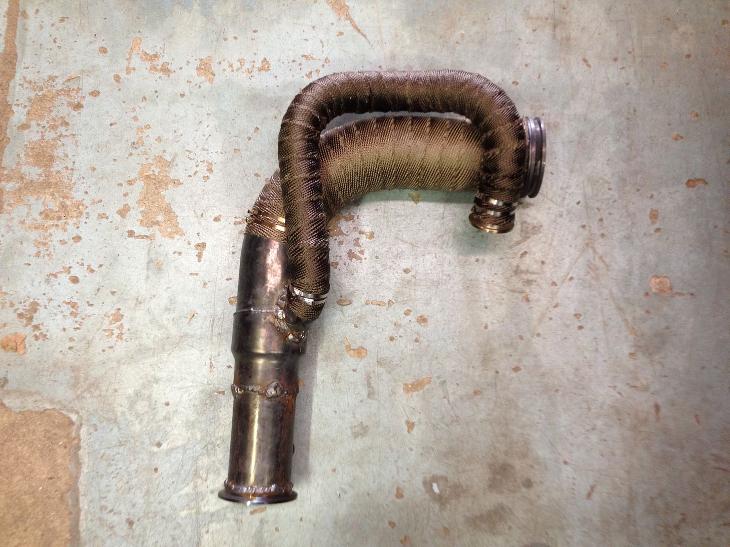

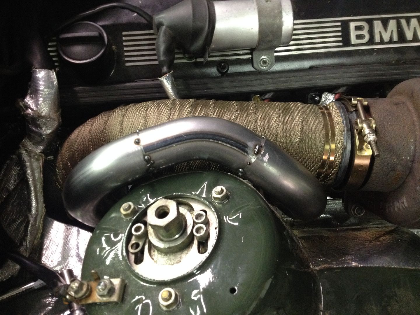

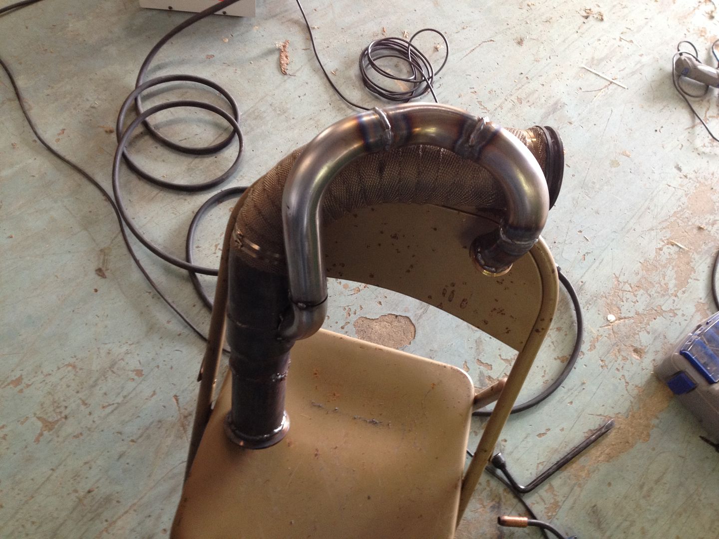

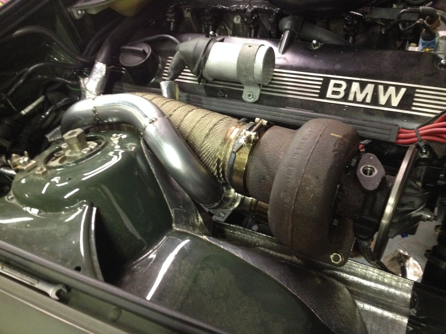

                        Down pipe progress!!!!!
                        Added a V-band at the bottom and finished the day with a wrap. Ignore the welds, I did!
