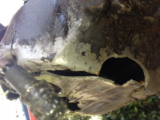

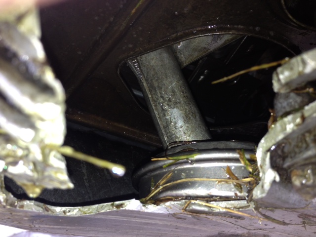

              or the quick way is to go off track at 120mph and get your e30/m30 airborne and land on something hard - problem solved - timing chain is easy to get to :)
