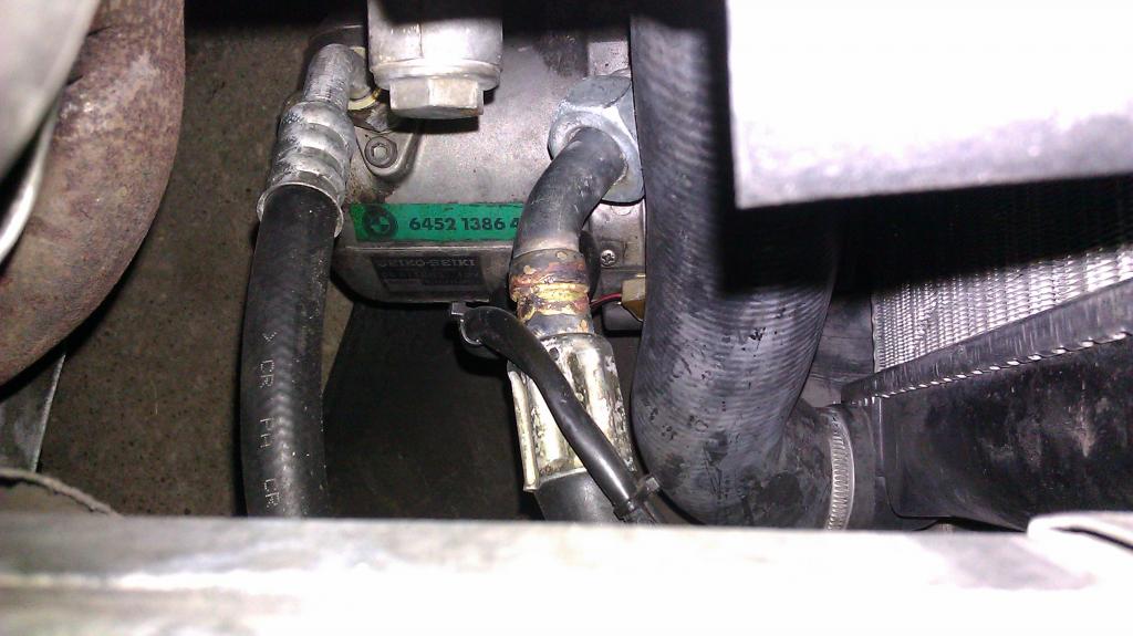

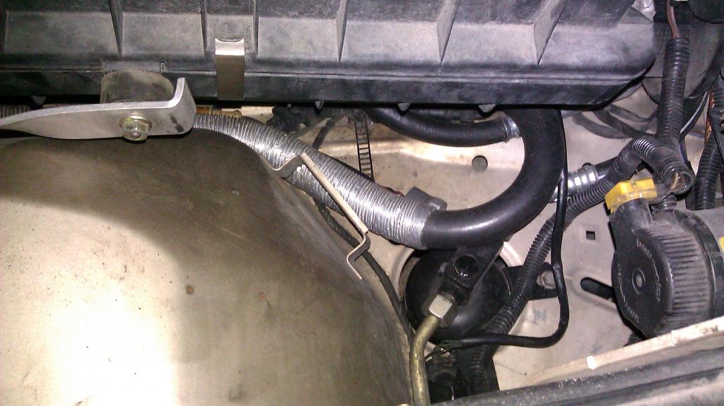

                I'm in Houston and my A/C blows ice cold! Like Nick said, the hoses fall short because the longer M30 block pushes the compressor forward. Had a local shop fab one up where the hose went to the front and then turned back. The trick is the AC belt, 865mm is easier to mount but adjustment is at the end range and you wear into your coolant hose. After two years it stretched and squealed at every light. OEM length 855mm is the way to go but you'll wear yourself out trying to fit it.

                  You have any pics of your setup?

                    I'd also like some pics. Curious to see what you did with your hoses.

                      The airbox was in the way.

                        Thanks for the pics. Just saw your PM earlier.
