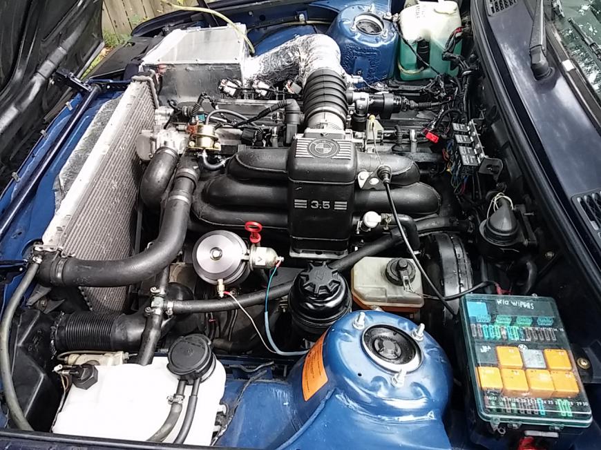

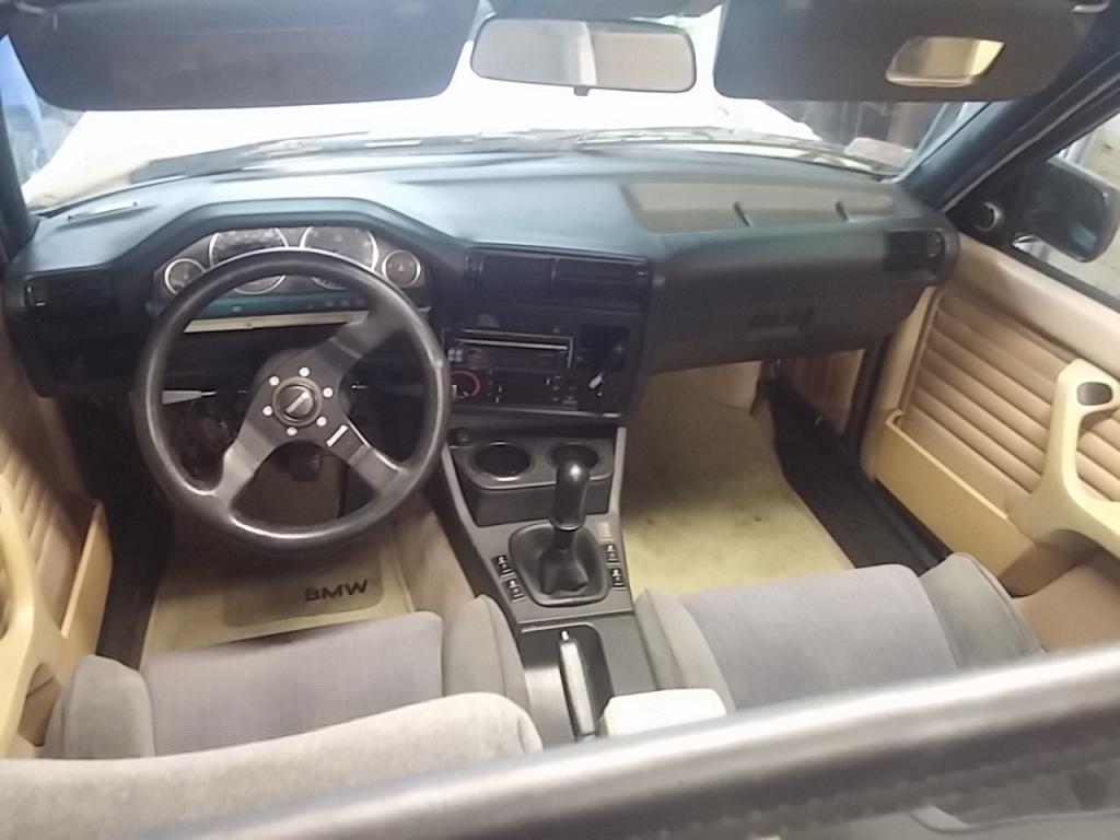

    Here are some more random pics. I went back to a stock steering wheel as the Momo interfered with me seeing the instruments, especially with the lowered column.

      Nice to see another m30b35 running MS around! Could you snag a closer shot of where your alternator snorkel meets the trim piece behind the headlights? I like how you have that set up, I might need to copy it :)

        The hole I cut for the alternator vent was less than elegantly done but I will try to get a better pic tomorrow. I think I used some kind of weather stripping around the hole.

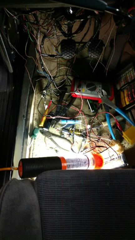

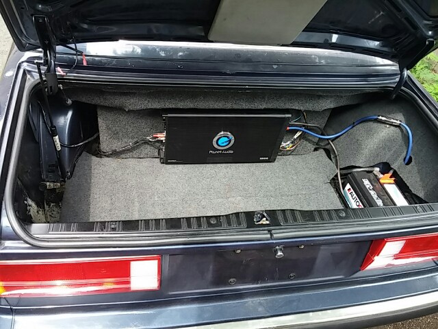

          Some wiring fun.
          As a side story on my first E30 which was an 87 325 the seller had started an e to I swap but didn't get it running. Because I couldn't get it to run either I brought it to a local German car specialty shop which looked good on paper to sort out the wiring and get it running. After about nearly 3 months of sitting ( and numerous promises of when it would be fixed) in his lot he finally admitted he wouldn't do the job and so pissed off I had it towed back home. That forced me to really look at the wiring and learn how to read the ETM (actually still learning more of it) and what I eventually found was some burned ground wires under the dash. Not sure when that might have happened but I cut out and spilced in some new wires and that got it running. As a result I don't hate working on wiring as much.
          I have a few wiring pics of my vert that show the good and the ugly but I can't get them to upload momentarily. Maybe the size is too big but I'm too lazy to bother right now. I am pleased with how the amp and battery are in the back. I may try a lighter battery later but this one only weighs 39 lbs. which isn't that bad.
          Correction: the battery is an Autocraft silver 91-1 which weighs 35 lbs.

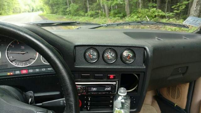

            I purchased some Koni 1021 adjustable front struts but have no idea when I will be able to install them. However I was able to install some transmission mount Enforcer cups I had laying around and also changed things up and mounted VDO cockpit gauges in the center vent instead of the digital ones. I prefer analog for this. Lastly I put the engine plastic under tray back on for ultimate aero efficiency.

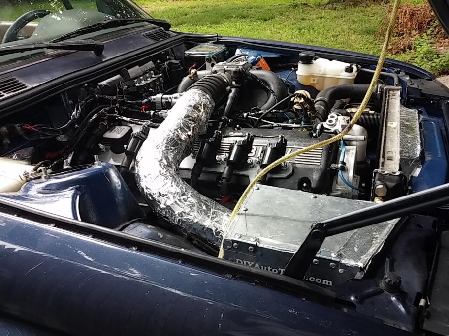

              Some of my earlier wiring fun. I may do it over this winter.

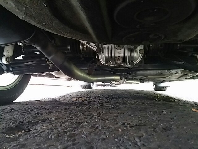

                        I finally got around to changing my exhaust a bit. I'm running 2 1/2" single pipe from the headers into a Vibrant Ultra Quiet resonator and then to Walker Dynomax Super Turbo single outlet muffler. What I changed was going from model 17733 muffler which has a 14" body to the model 17748 muffler which has a 20" body. The same muffler just longer. I am very happy with the difference in sound. The smaller muffler would have been fine for track use but the bigger one is way better for the street as it sounds quieter and deeper.

                          Your MS set up is also giving me bad ideas about mine BearMW :devil: ... I'd love to set mine up with a wasted spark system to give me more room at the front. I already have a distributor blanking plate from one of the group buys on here.
                          How's the drone with the 2.5 inch single? I run one on mine, but it drones pretty bad. Longer term I'm thinking of going over to a 2 inch twin system, although this will be fairly pricey to get fabricated.
                          Corvallis - for the snorkel, the simplest thing to do is use the e32 piece.
                          Strangely with minor mods it fits straight up to the stock e30 inlet that was originally there for the M20 air box. The trumpet forcing extra air into the alternator is no doubt overkill, but it works fine and looks neat.

                            The alternator trumpet helps support my cooling hoses between the overflow reservoir and the heater core and t-stat housing. I have toyed with the idea of a lightweight alternator but that would require making a hose support as well so its on the back burner.
                            I had some drone with the smaller muffler for sure. I have never run twin pipes on the M30 so I have nothing to compare to but imagine that could eliminate drone. Just look at how heavy and overbuiIt a factory M30 exhaust is and its easy to see one way to make an exhaust. I am happy with my current setup but could probably quiet it a little more with a longer mid-muffler instead of the resonator I have but how much difference it would really make I have no clue? I like the current sound. Like any custom setup it comes down to trial and error and what is acceptable is very subjective.
                            Right now most my noise comes from the super thin hood and my alternator has some scratching or chirping noise (but it charges fine). Oh yeah and taking advantage of the broad torque band whenever possible.

                              I have a fairly small rear muffler and quite a long resonator in my exhaust, it's not raspy at all, so maybe I just need a bigger rear muffler.
                              It's certainly subjective & many people jump in my car and say it sounds awesome, it's just I drive it day in day out, so it gets a bit tiresome... that, and I'm not 18 any more, I'm sure I would have loved it when I was younger :D
