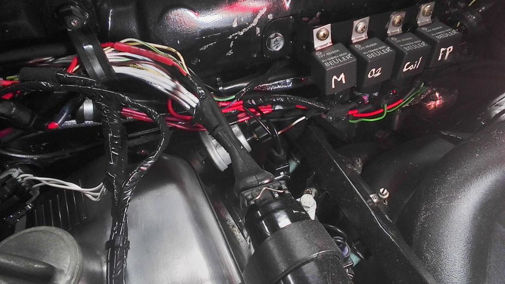

    #61
    Although it looks like regular electrical tape it isn't. I learned that regular electrical tape gets really gummy and sticky when exposed to heat so I got some non-adhesive harness tape and just secured the ends with the sticky stuff. The non-adhesive stuff is pretty cheap and easy to undo if need be.

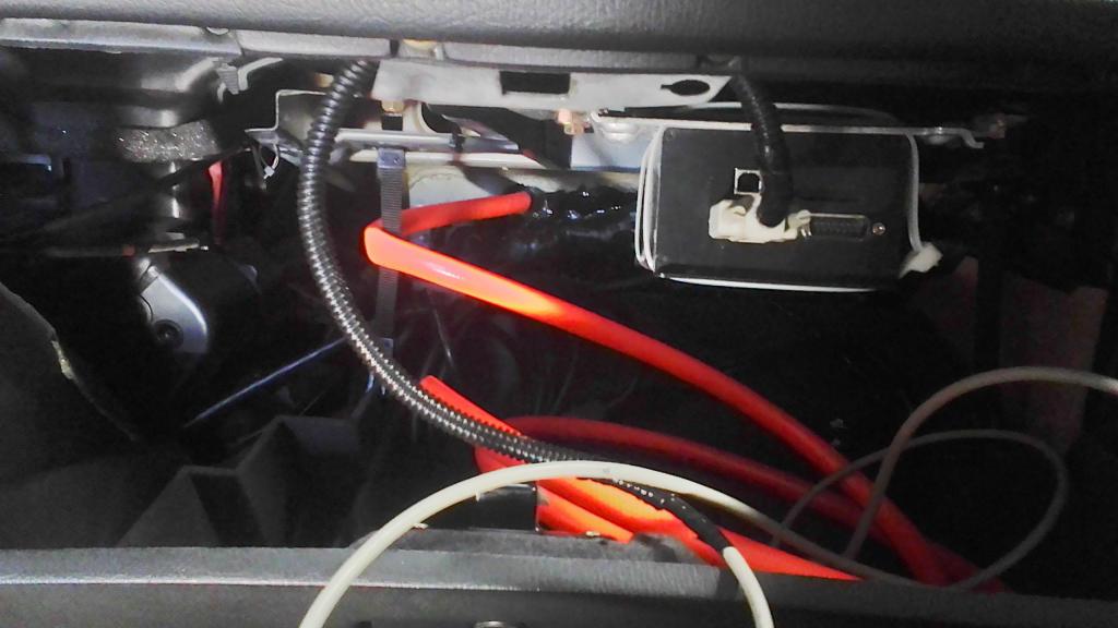

      #62
      The ms3x unit. The orange hose is for DET CANS I made so that we can listen for detonation when I finally get it on a dyno.

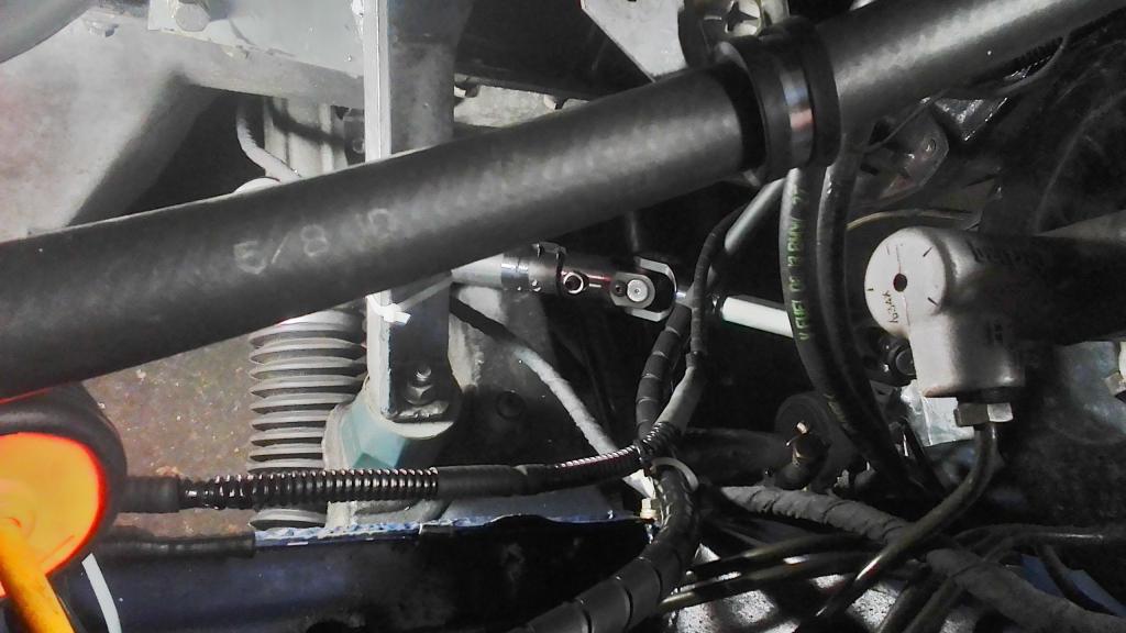

            #65
            Here is a shot of my steering linkage. I went with Flaming River stuff. I really like the direct feel of the manual rack. It is 3 turns lock to lock and is not progressive. What i realize now is that there is a small amount of play which I think is the lower steering collumn bearing. It is nothing major at this time so maybe I will get around to replacing it next winter.

                    #69
                    What I thought was a bad steering column spindle bearing was actually the 3/4" DD rod that goes in between the two steering joints. When I made it I was less than precise which allowed for a small amount of play. I made a new rod with a bit more attention to detail and the play is gone.
                    Now I realize that I have a bit more steering effort than I like which is in part due to the extra caster from the E30 M3 offset CABs. I am probably going to swap the offset bushings for some 96-99 M3 centered bushings. With power steering the extra caster is no big deal but with manual it is for me. Since I seldom drive the car at high speeds of over about 80 mph I don't think I really need the extra caster.

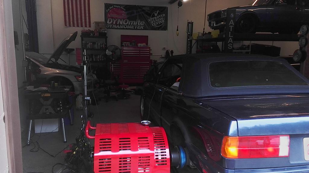

                        #71
                        Managed to get the car on a dyno for cleaning up my tune. I went to Six Sigma Tuning in Brentwood N.H.
                        Kevin who owns the shop and does the tuning is a real nice guy and he explained everything he did. I recommend his shop for tuning or fabrication. Kevin uses a Dynomite dyno because it is very consistent and can be used on the 1000 HP cars that are sometimes in the shop.

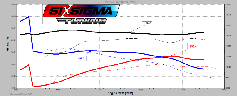

                            #73
                            The tune gave me about 15-20 more overall HP. I lost a small amount in the midrange because I had a bit too much advance to be safe in that area. I learned that this motor is a bit knock limited so with higher octane fuel I could get some more power but I am not going to do that...at least for now.
                            The driveability is significantly better and much more responsive. I should get better gas mileage too. I take the numbers with a grain of salt as what I was looking for was improvement. The faint dashed lines are what I started with.

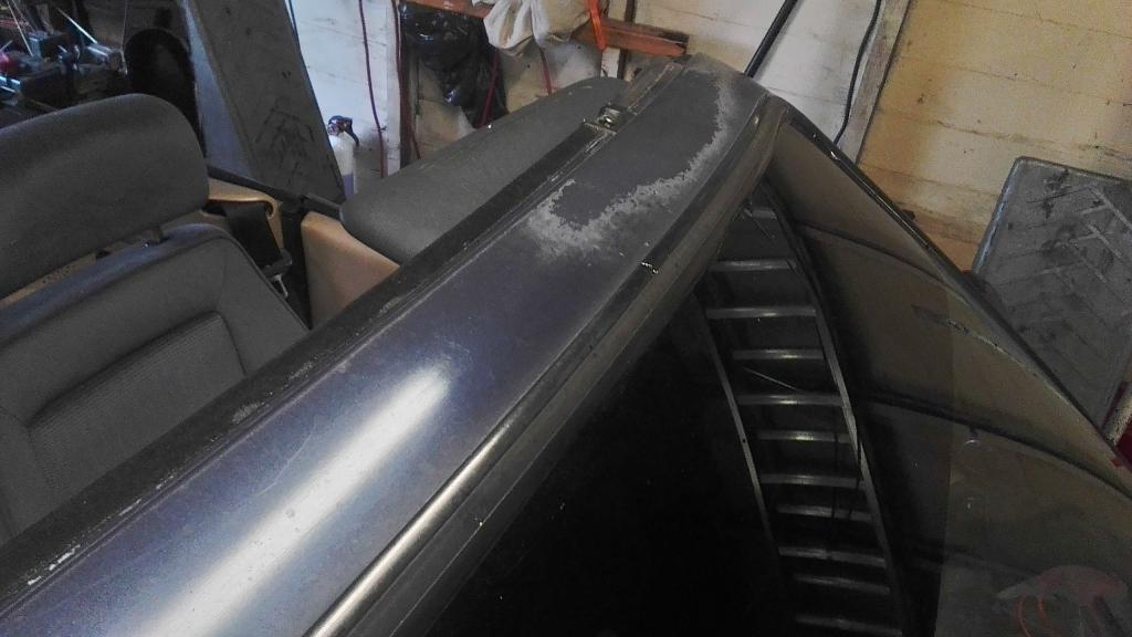

                                #75
                                This should help with intake temps.
