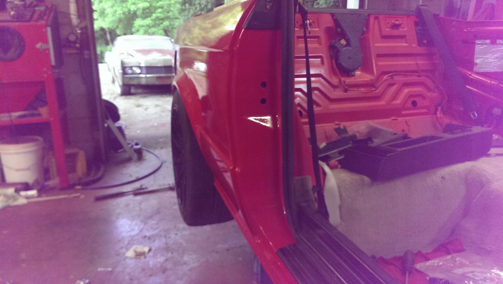

    Interior Update
    With the harness inside the passenger compartment buttoned up, it was time to tackle the instrument cluster. Turns out, Batteries Plus found an exact match for the lithium batteries powering the SI board--including the welded-on tabs! 20 bucks and a week later, they were at my doorstep. Since I am no soldering wizard (actually more like the Sorcerer's Apprentice than anything ;)), I found a company that put them on the board for me.
    A few screws, and a bit of cleaning...and

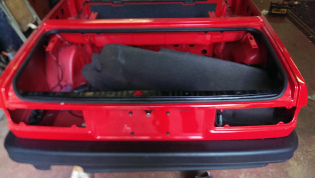

    Meanwhile, I decided to get the trunk into better shape.
    It has been low on my priority list...but the carpeting has been getting in the way recently. In the process, I decided to go ahead and build the new subwoofer "box"

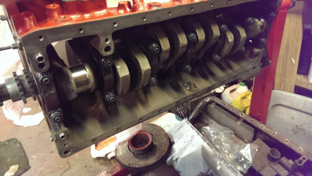

    Engine Update
    With the crankshaft installed, I had finally come a point I have been dreading...sandblasting the tops of my brand-new forged pistons
    No going back now.

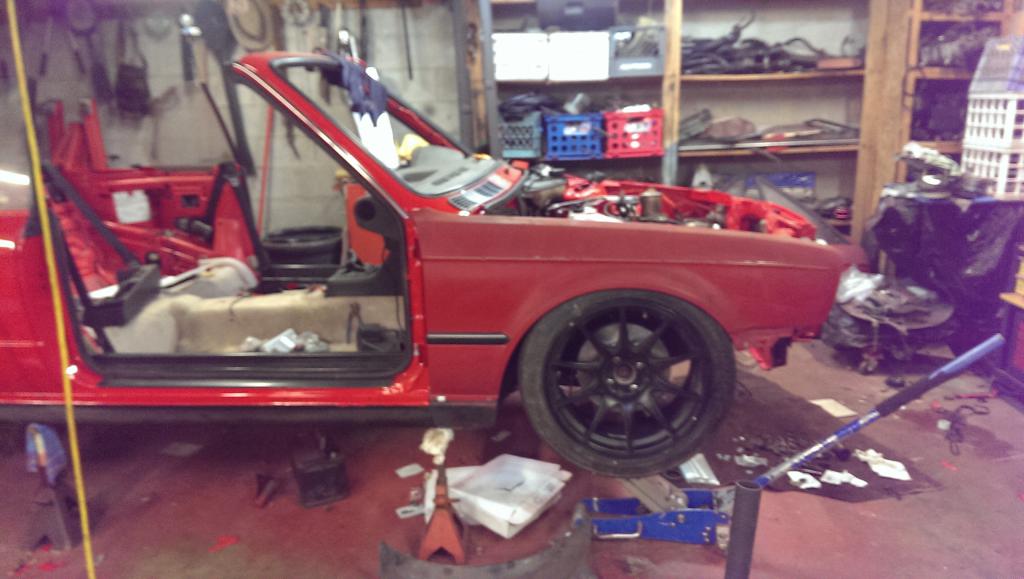

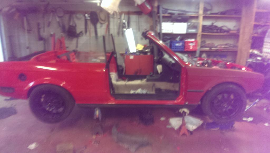

    Bodywork Update
    With the suspension nearly done, I realized it was finally time to start getting everything else looking nice--not to mention getting a better idea how to fit everything inside the panels. Once again, the stripper comes out...
    If you think watching paint dry is boring, watching paint undry is somewhat more fascinating :) Still, since I had some time to kill, I figured I'd be productive...
    Weatherstripping, locks, and plastic panels? Check!

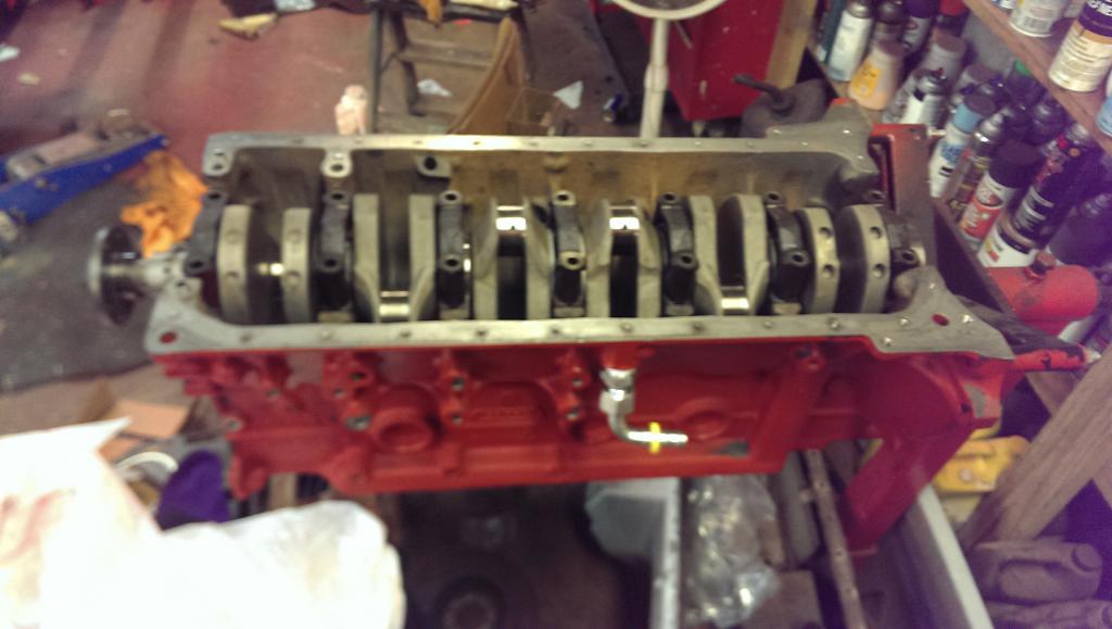

    Engine Update
    The body wasn't the only thing that got some attention...
    With bearings in tow, and my freshly arrived ARP main stud kit, I now have a moving part! :D

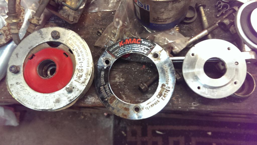

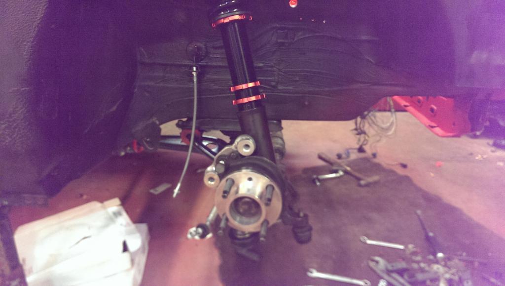

    Suspension Update
    Thanks to those shiny new adapters, and my new lower control arms, it was time to bolt down the suspension and set the coilovers. I took out the springs, and adjusted the compressed damper height.
    At full compression, it is about a 1/2" from hitting the studs on the top of the wheelhouse.
    I marked the length of the damper from the top of the damper to the bottom part (the part that's welded to the knuckle), and transferred it to the other side. After that, I adjusted the dampers in the rear to match the (uncompressed) height of the fronts.
    It's not exactly a lowrider, but it appears to be the most effective use of the damper travel. I figure it can adjust the ride height when I set the preload on the springs.
    I do know that I have some fender rolling ahead of me...
    Not only that, but I'm going to have to add clearance to the front of the front wheelwells, to permit full steering travel :???:

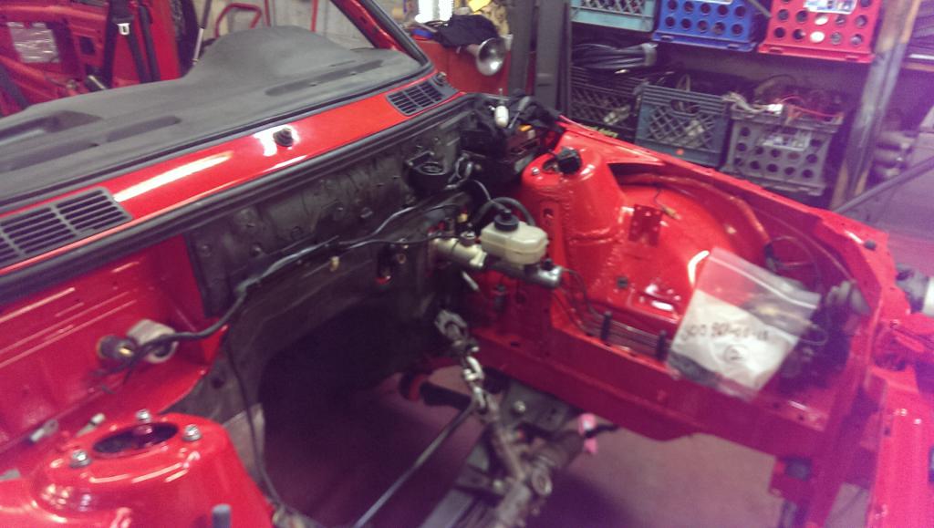

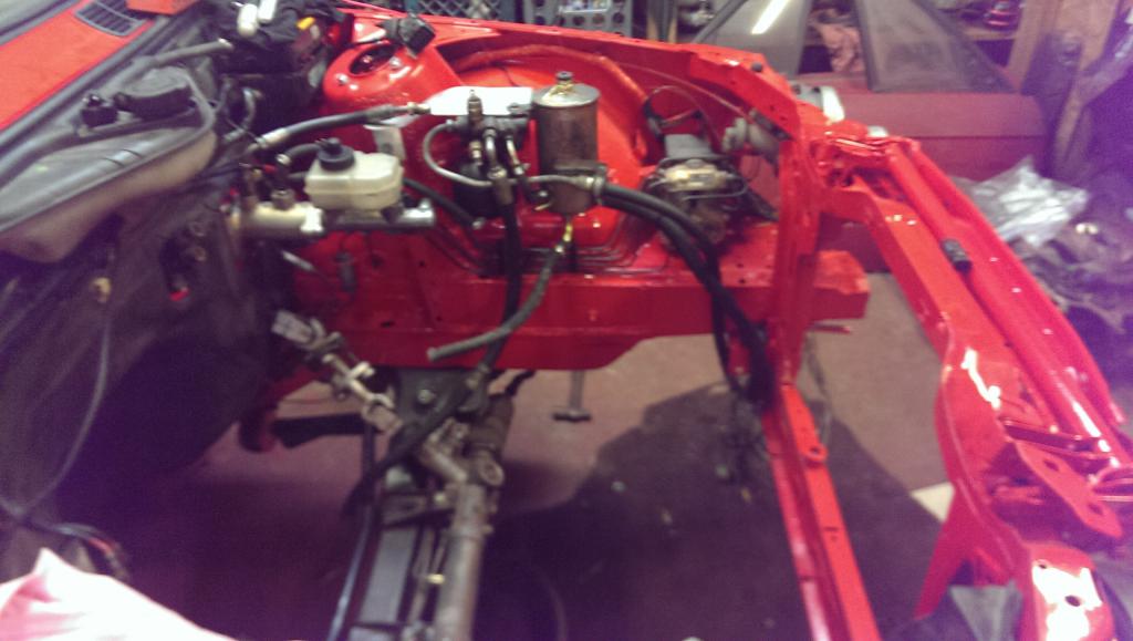

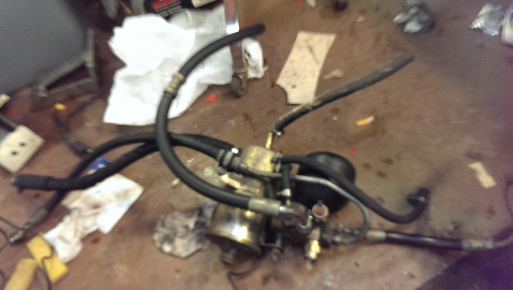

    Braking Update
    I wanted to get the rest of the hydroboost system in place, and that meant fabbing up a bracket. The system looked like this when I pulled it out:
    So, I kept the dimensions roughly the same, and tucked it close against the strut tower.
    Spiffy :D I used a mixture of E30 and E23 hoses, but I did have to extend a few of them...the hydraulic hose shop is not cheap, but they do very nice work. More on that later ;)

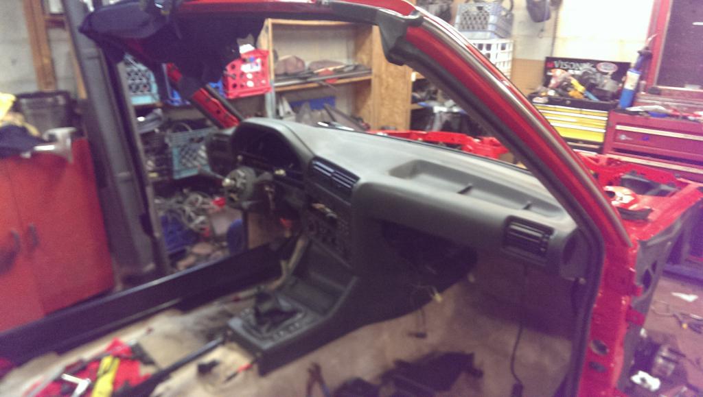

    Interior Update
    So, it just happened: one moment I'm staring at the ground points on the firewall, contemplating what to do--the next moment...
    It makes me happy to see the dashboard in, but I can't escape the gnawing fear that I've forgotten something, and it will all have to come apart again
    Braking Update
    Thank you for your kind donation, Mr. E23!
    I'm familar with how nice the hydro system is when on a 735i...I hope it feels the same on my car :p Looks like a few new high-pressure hoses, and I'm in business!

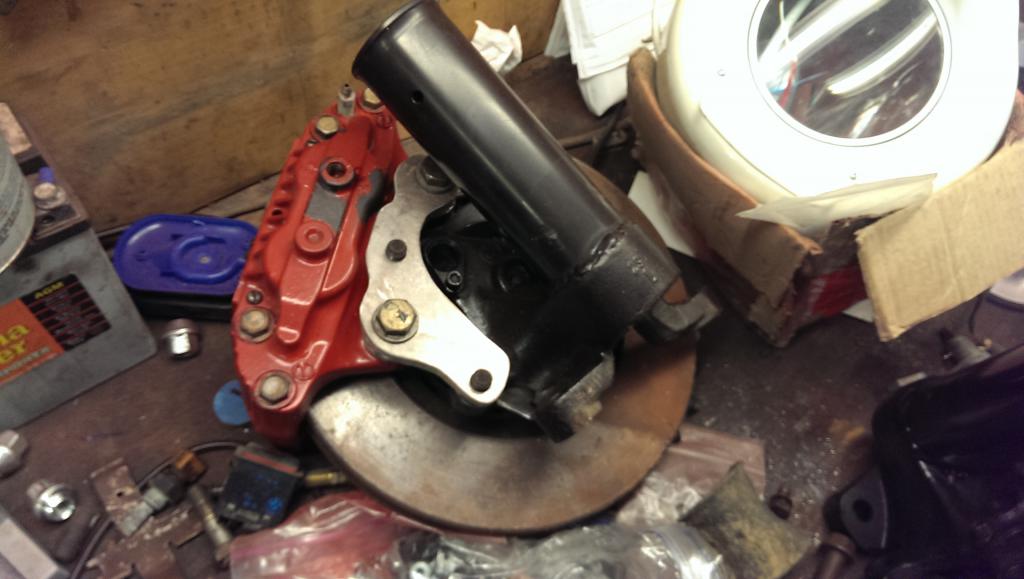

    Suspension Update
    The rear subframe is finally in the car! Of course, that meant installing the fuel tank, brake/fuel lines, and filler hose/EVAP system--but that's not nearly as cool :D

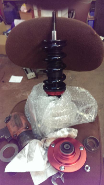

    I know there's not much love for the CX Racing coilover setup--but I consider it a valid starting point. If the springs are junk, they're easy to swap out...same goes for the dampers, though with more effort.
    However, I am not happy with what they offer for front camber/caster adjustment, so I decided to find a way to make my old K-MACs work with them....
    More on this later ;)

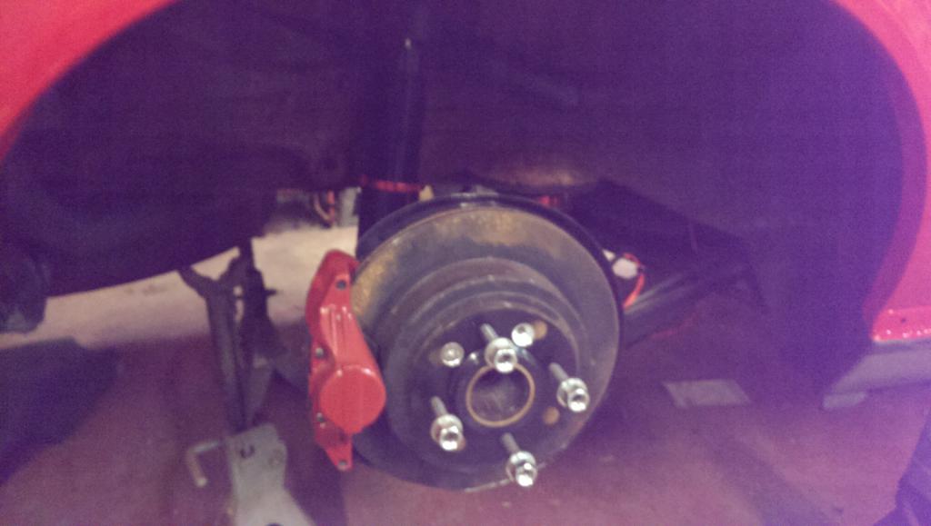

    Braking Update
    The front caliper adapters came out perfectly!
    I've redrilled the new lug holes in my Sonata rotors, so the next time you see all this, it should be attached to the car :)

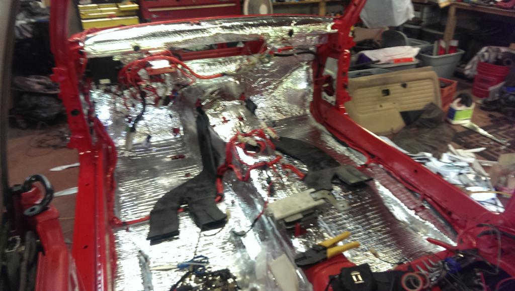

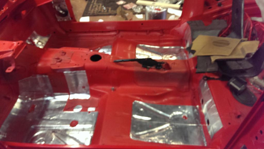

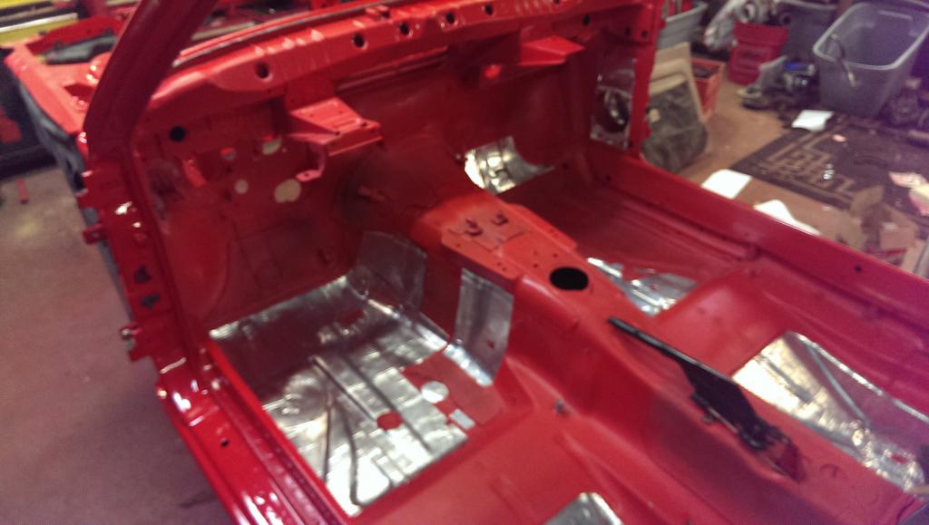

    Interior Update
    With the paintwork on the body finally finished, I could finally get some actual work done! I started with sound deadening panels:
    Thank you Home Depot! FWIW, I did quite a bit of reading before deciding on the "Peel 'n Seal method". While it's true it adds some weight, and is nowhere near as effective as modern Dynamat, it's very similar to what our cars originally came with, and works well enough for my purposes :)

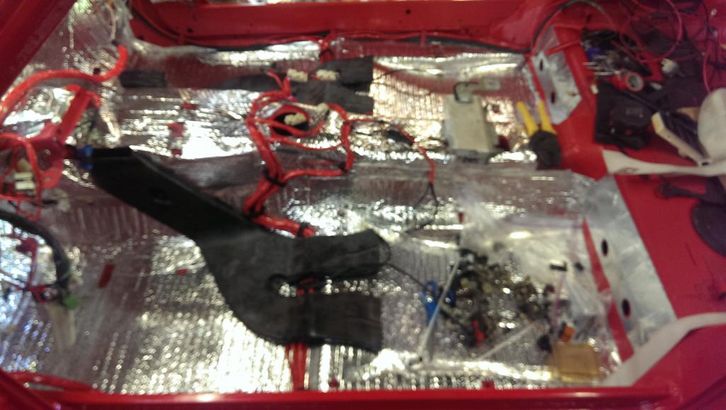

    Next, the insulation--also courtesy of Home Depot (or Racer's Depot if you're trying to be cute):
    That's a layer of duct insulation held down with aluminum tape--it's good for an R-6 rating as installed. It has aluminum foil on both side, and essentially heavy duty bubble wrap in between. The concept involved is similar to how Lizard Skins works.
    After that came the electrical harnesses, a task so foul--so hellish, I did not save for posterity. A word to the wise: next time you see your harness and think "that cloth tape is in terrible shape...I should really rewrap my harness" walk up to your cat and rub his tummy for about 10 solid minutes. At least that will hurt less
    Anyways, with that done it was time for carpeting. I took a tarp, made a redneck swimming pool, dunked the carpet in there, and sprinkled in OxyClean. I let it sit overnight, then got out there with a stiff nylon tire brush and scrubbed the crap out of it. When I pulled it out, the water was brown and chunky!
    It had been growing algae, had grease and rust stains, and had brake parts laying in it for a year, but after all that, this was the result:
