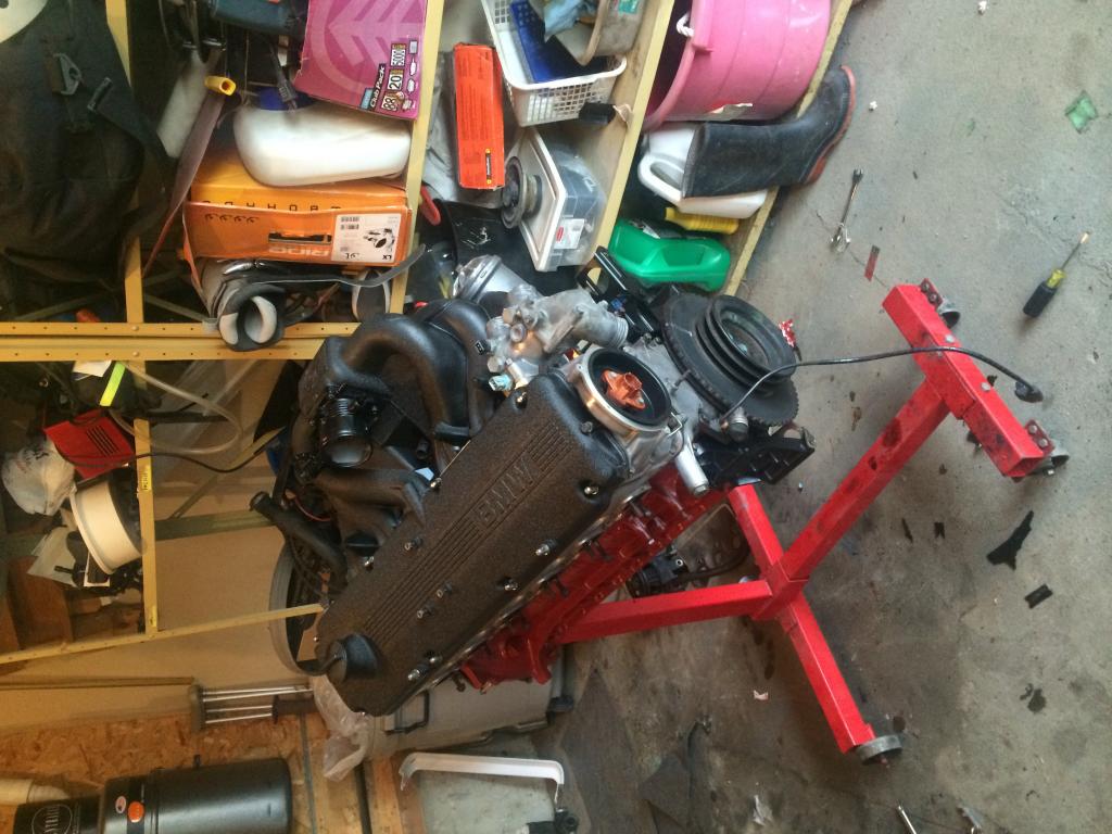

        • curtis_luu
          • Jan 2015
          • 51
          Pic of engine!
