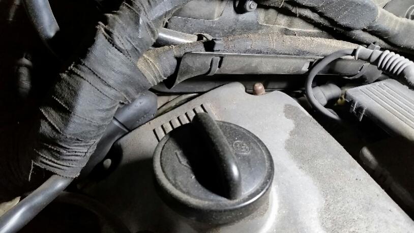

              m30 e30 pics
              Here you go. No hammering of the firewall. Position 2.

                Awesome thanks. That should do nicely.

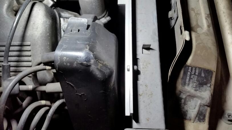

                    My Personal experience with my M30B35 swap:
                    M30B35 from 1991 E34
                    Getrag G260/6 from the same car.
                    Garagistic M30 swap mount arms.
                    New stock E30 M20 rubber mounts.
                    My car is a 1991 325i 4 door.
                    Never been in any wrecks or accidents.
                    I made no modifications to the firewall when putting the engine in.
                    I didn't even remove the foam material.
                    It just kinda fit without doing anything.
                    Although I do hear some vibrations upon startup and shutdown that could be coming from this area, not sure however, no vibrations while driving though. (could be unrelated).
                    My radiator is pretty much touching the distributor plastic cover. Maybe a few mm clearance.
                    I do have the stock radiator top mounts, which could have been trimmed to be brought closer to the front of the car and make more clearance for the dist. cap.
