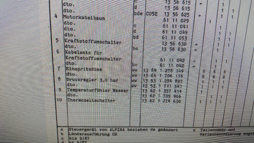

    Does anyone know what Alpina used for fuel injectors in the B6 3.5?

      Alpina used the stock injectors found on the e34 535i M30 motor. Same injectors used on the e30 M42 motor.
      Line item #7 in the picture.

        Thanks. I have that page, if it was only in English.
