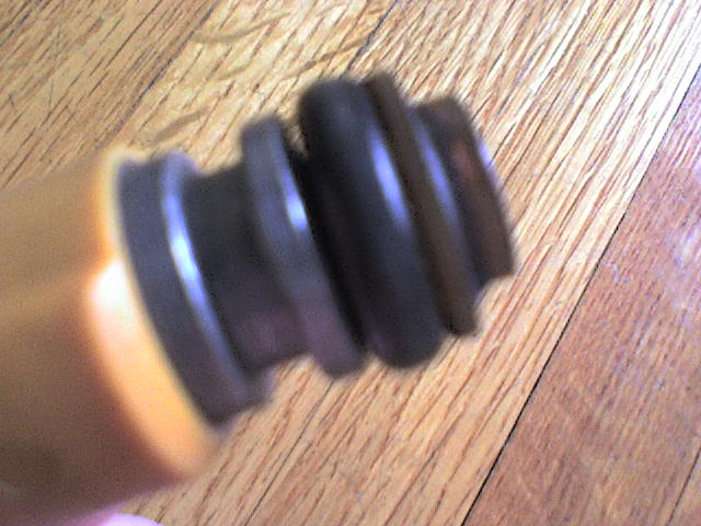

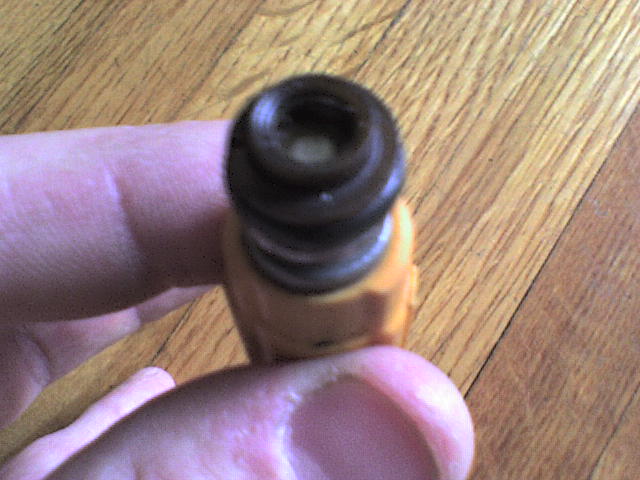

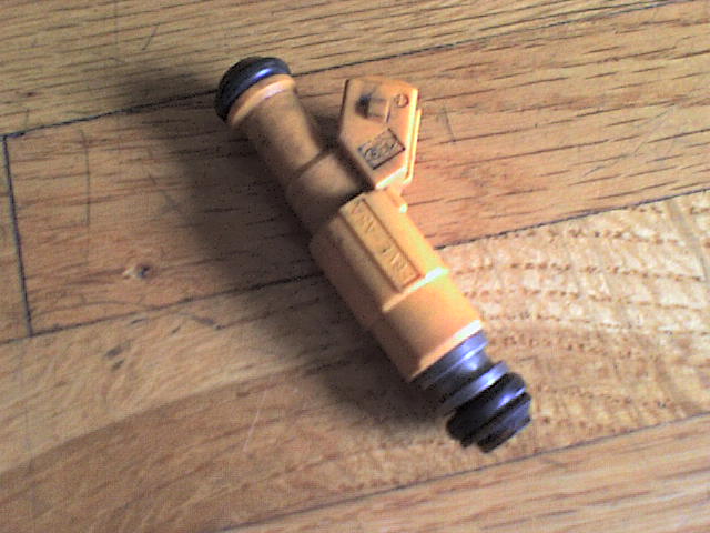

    Getting ready to install #19 Des III Bosch injectors. Currently fitted with 2 O-rings. Comparing them to the original, they dont have the plastic cap and that plastic ring above the O-ring that seals the injector at the manifold. Are the cap and ring needed for the Des III type?
    If so, anyone know of a source and/or part #?
    TIA.

    Images of the injectors
    • xLibelle
      • Aug 2004
      • 2673
      If each of the injectors are like the one in the picture, then that is how they are supposed to be. just install like normal. (do NOT remove them - they are very brittle)
      if not, you are in for a headache. i went through this in early sept.
      you will have to do a search on the net for any injector service shop and ask if they have extra of this specific pintle cap to sell. the o-rings are common part, pick em up anywhere.
      if anyone has a way of finding these orange pintle caps, let us know. i had a bosch parts list for injectors but was unable to do anything with the numbers as no one carries this specific cap.
        yup he is right. You can not source those caps anywhere. Actually I did find a place in australia that makes them but you had to buy 10k+ of them. Regular ones from design I or II are about 15-30 cents.
