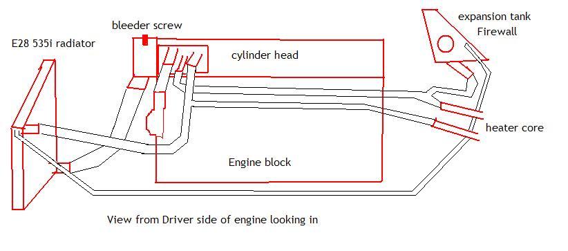

            My setup
            Here is my setup
            Here are a couple of tricks I'm going to try...
            If I don't have heat, I'll feel the heater pipes (inside the car) and see if the heater core is bad. It shouldn't, however, prohibit proper cooling of the Car. Think about it as if you had deleted the heater core altogether.
            I think i'm going to drive the car around just around the neighborhood. It could dislodge and re-organize the coolant within the system and open up some of those air bubbles.
            For the record: WITH REGARD TO THE FIRST POST, I NEVER HAD THE CAP ON FOR EVEN 1 SECOND, SO THE SYSTEM WAS NEVER PRESSURIZED. Since the coolant was overflowing so rapidly from the reservior, I was afraid to close the cap due to bursting hoses...
            Take a look at the pic and again, thanks for the help.

                  BTW your hose lay out looks OK

                    Great. Thanks for the help. I'll try it again in a few hours after I get back from work.
                    So the hose coming from the coolant reservior should go to the TOP heater core inlet, not the bottom.
                      Thats the way i've got mine, not sure if it make any difference though TBH ??
