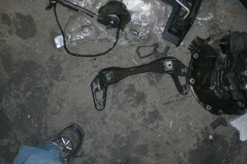

              Well we got the tranny mount issue solved. We ended up using a crude sheetmetal mount from a 5 series automatic. Its the rear style mount with just one mount. This will get us by until we can find something more appropriate.
              George, thank you for your assistance with the M3 mount. It has been a bit confusing and I have to admit this swap has turned into a bit more work then I was expecting, but custom stuff is never easy.
              Part of the issue we where having is that we have 2 brand new AKG poly urethane tranny mounts and would like to use them. All the mounts including the M3 put the mounts at a angle... At least from the Real OEM views. I understand these are not always correct but without seeing the mount in person its hard to determine.
              In the near future we will revisit this issue but for the time being the mount problem is solved.
              As a note I also found the original mount that I made this thread about and also madhatter had also posted the part number. I ordered it from the dealer, and the mounts are placed at a angle and we would have to use the factory rubber mounts for that application. Again, we would like to keep the brand new poly mounts.
              Thanks again to everyone who responded in kind to help.

                I was looking at those pictures and thought they looked familiar. That's MY tranny and engine!
                Sorry I was gone so long, and couldn't help!
                Slicktop City!
                • peerless
                  • 285
                  We found that exact mount at the junkyard today so we bought it. Its to wide to fit the E30 chassis. You would have to cut it in the center and shorten it about about 1.5".
                  I have to assume you haven't done your swap yet.
