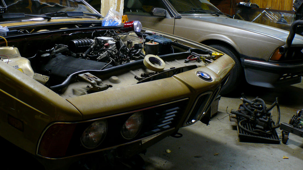

    The time has finally come to get my 635CSi sorted. I have owned this one since May of 2007 and barely logged 1000 miles because of various issues, mostly related to a non-functional speedometer, funky brakes, a horribly choked up federalized exhaust system that made the engine essentially stop revving at about 5000rpm, and bad valve guide seals that cause it to blow smoke pretty much all the time. Pluses for this car are the Getrag 262 Dogleg gearbox and lack of sunroof. I have been collecting parts over the spring and summer so it's time to get to work!

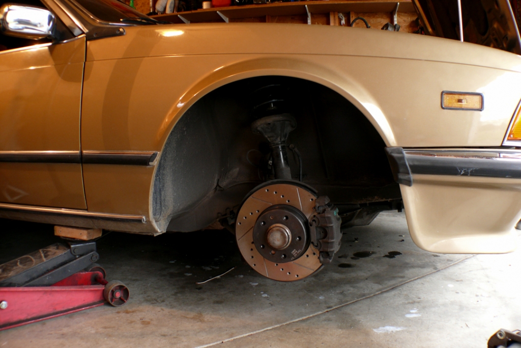

    I needed some brakes... badly. Got a killer deal on a good pair of 750il calipers and close-out Tar-Ox J-Sport rotors. Insane stopping stopping power. Apparently this combo produces nearly the same amount of torque as the 4 piston Brembo setup used on the late E34 M5s and 850CSis but for a fraction of the cost.
    Next I swapped out the entire front half of the chassis wiring harness along with a good fuse box from an '85 635. Not a project for the feint of heart.
    Fast forward to now. The crazy ass EGR setup, plugged exhaust, and smokey engine gotta go. Don't worry, the Euro spec B34 will be seeing duty elsewhere (in my 535is).
    I scored a killer deal on two E24 parts cars here in Colorado. One was a complete '89 635CSi Highline that had some work done at Dinan in 1991. In addition to an incredibly well running M30B35 with a Dinan chip, the car also had a set of 16x8 and 16x9 BBS RSs and Dinan modified front and rear subframes (the rear has eccentric adjusters on the inner trailing arm mounts). The B35 will be exhaling through a pretty set of headers and an IE catback. It's filthy here but it will be nice and clean before it's installed.
    So here we are today. Coolant is draining as we speak, and the old B34 should be coming out tomorrow or the next day. I thought about painting the engine bay while it's empty, but I still can't decide on a color, so I guess it will all be coming out again at some point!

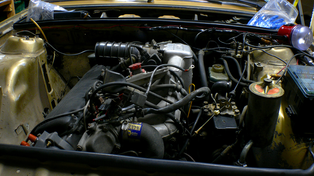

      Hey euroshark, whats with the plug just above "3.2" on the e24's m30?

        I'm not really sure what that thing is... It's phenolic and it seems to be epoxied in place with no clue as to what may have plugged into it at some point.
        This car was absolutely bastardized by the company that federalized it though... Wiring hacks, air pump, egr, incredibly choked up exhaust (I'll post pictures once it's out), etc. I am going to undo each and every one of those evils and make this car better than new!

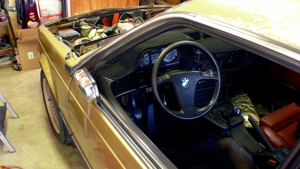

        Here are really the only flattering shots I have of the car so far... Both from about a year ago right after I sold my 533i to a friend. It's sitting on H&Rs and 16x8 Style 5s in these shots. The rear bumper is hanging funny too... Still working on getting it straight.

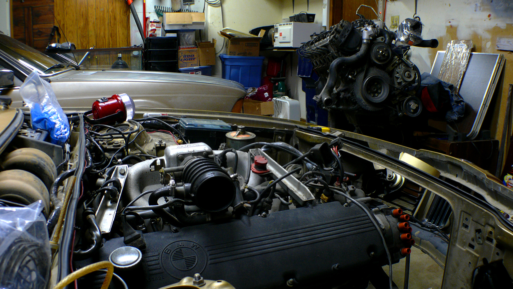

                              Not a super exciting update... that should come this weekend. Got the bulk of disassembly done. The engine should come out tomorrow, then comes massive de-greasing and scrubbing. Once everything is cleaner I'll be swapping in all of the braking components from the '89 since it's all minty fresh and pretty. After that there will be all new fuel hoses, PS hoses, some wiring harness love, and euro oil cooler installation (this car is a euro model but doesn't have one... very odd...).
                              This thing is a nasty, greasy mess! Honestly, it surprises me even more than my '87 535is did when I got it. That car was pretty dirty and neglected under the hood (and pretty much everywhere else), but this 6 is freakin' GROSS. Never again, my precious. lol. Where's my beer...
                              Oh yeah, I ended up removing damn near 50lbs from the front, and I'm moving the 45lb battery to the trunk, so I should be getting mighty close to 50/50 by the end of this project. That makes me pretty happy.
