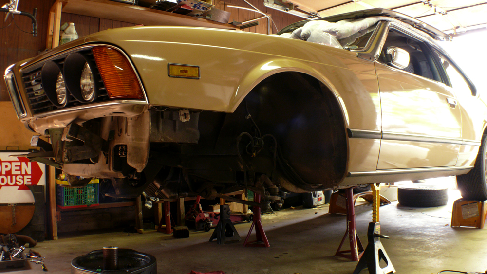

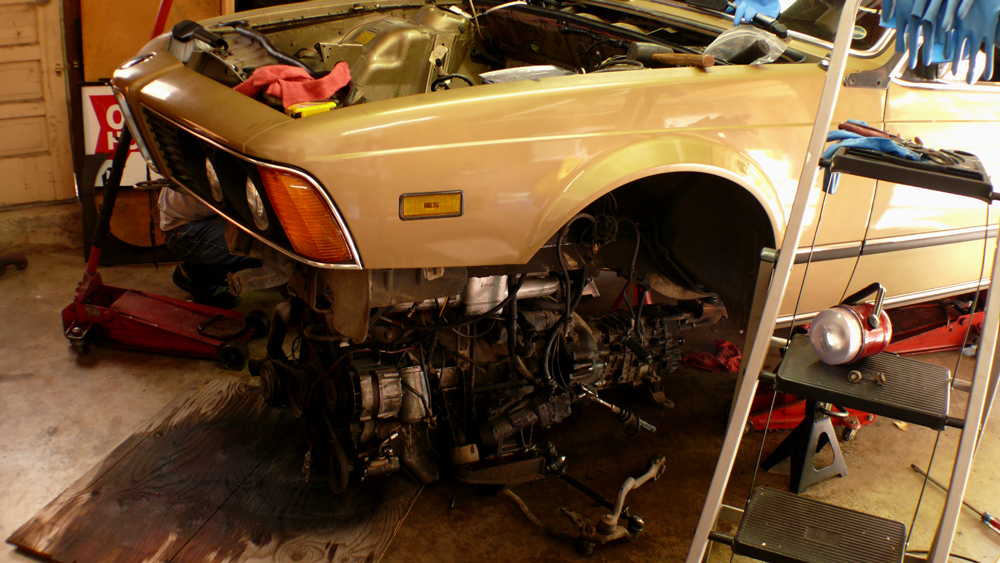

                Alright! Finally got off my ass and removed the smoky old B34 today. Went off without a hitch! Dropped it out the bottom as that seems to be the easiest way as long as you have three good floor jacks and a nice piece of plywood to set the assembly on once it's on the ground. On to the sheety pictures.
                Front suspension off, exhaust off, driveshaft outta there. Engine is ready to drop.
                *blarf* Engine is on the floor. Only takes about 5 minutes to get her down safely by yourself.
                Here's a great shot of the greasy old mill and the nasty ass hole that is lived in for the past 25 years.

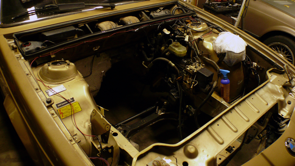

                Popped the new front subframe on (not painted yet) and rolled the car out to get my scrub on. Two hours, a few scotch brite pads and some old toothbrushes later, and we have a pretty damn respectable looking engine bay. The car will be getting painted soon so I didn't mess with the sound deadening / heat shield material on the firewall at all.
                Need to clean up those heater fan housings now that I'm looking at the pictures... More to come later!
                That red wire that runs across the firewall and down the passenger inner fender is the jumper for the main relay. A few of you guys know what I'm talking about ;)

                  So what's the deal with the jumper...for those guys that don't know (like me).

                    It seems that a lot of M30 swaps into earlier cars require a jumper from the positive terminal on the coil to the center pin of the main relay in order to start. Same situation here except it was an early engine harness interfacing with a later chassis harness. It has to do with the C103/C104 plug in the dash. Sometimes they just don't seem to want to work together.

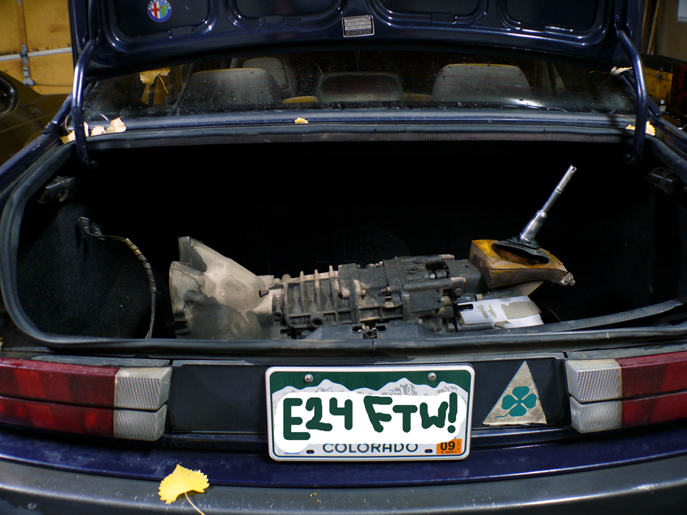

                        • euroshark
                          • Apr 2006
                          • 3491
                          Got the dogleg box in the trunk of my Milano... I honestly didn't think it was going to fit, but ti barely made it in there. Off to work to be cleaned and freshened up!

                            Hey dude, I plan on using this particular shifter for my e30 335i, I'm going to make it work eh.
                            My old 260 and I think I put my 265 into my e30 boot/trunk... Fit like a glove however I didn't have the shifter still on!
