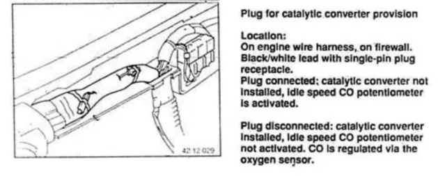

                Had a similar issue on my M42. However, this was on an E30 so I'm not 100% certain that my case applies for the E36 wiring loom.
                Anyway, in my case the symptoms you describe were caused by a embarrassing mistake a made during an engine swap, where I connected two wires beneath the plastic cover on the firewall which are to be disconnected for cars equipped with catalytic converter.

                  Originally posted by KMT
                  Apologies for the late reply, signed up to the forum just now.
                  Thank you for your response, KMT! I tried looking into this, but didn't immediately see anything, Additionally, I am on my original engine.
