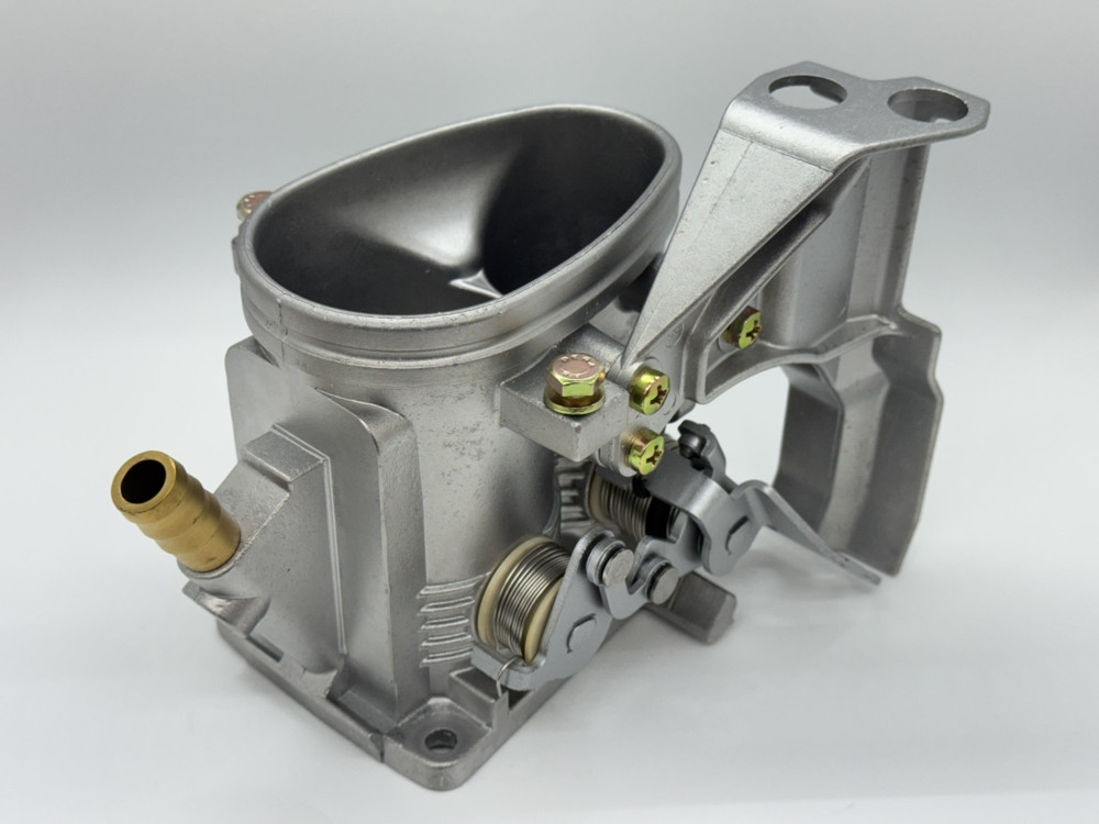

          The issue that causes the problem you have is in the linkage itself, or the bushings, corrosion has worked its magic and caused the bushing to cut into the shaft. Long story short its a parts unit at this point, it will need parts you can't buy to fix it, so its a donor for another...
          I refurbish these to the expected standard, along with all other E30 throttle bodies. New bearings, seals, vapor honed, plated etc etc. Smooth as butter and looks better than new. M42 units aren't on my web store yet, but will be soon. If you want to smack the east button and buy one that is like new while sending yours in as a core let me know.
