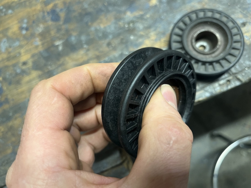

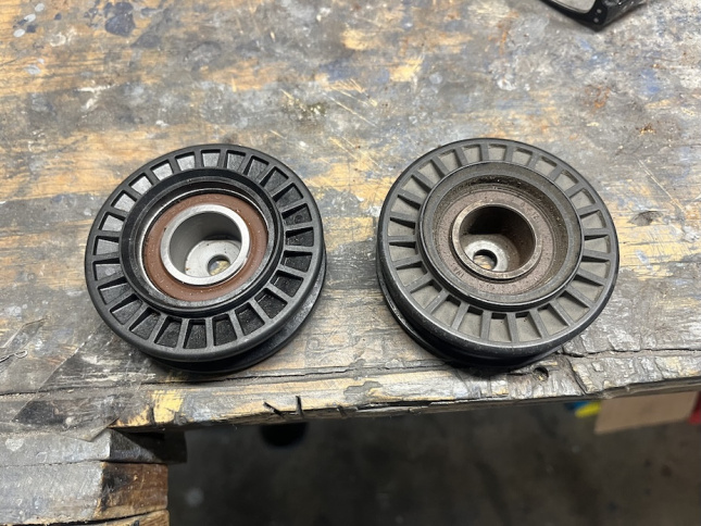

                    Here is the new vs. original pulley side by side.
                    Click image for larger version  Name:	IMG_7552.jpg Views:	0 Size:	174.5 KB ID:	10157934

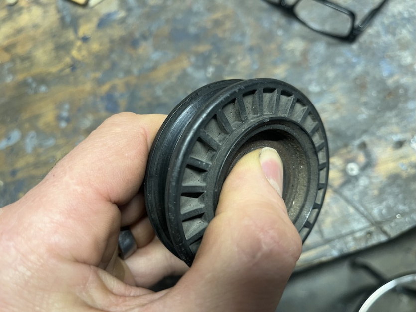

                    Original has a worn groove in the pulley (shiny area). It's actually deep enough to have formed a ridge. Bearing feels fine but never know under load.
                    Click image for larger version  Name:	IMG_7553.jpg Views:	0 Size:	172.4 KB ID:	10157931
                    New lacks the groove...
                    Click image for larger version  Name:	IMG_7555.jpg Views:	0 Size:	171.4 KB ID:	10157932
                    Fingers crossed thats all it is!
