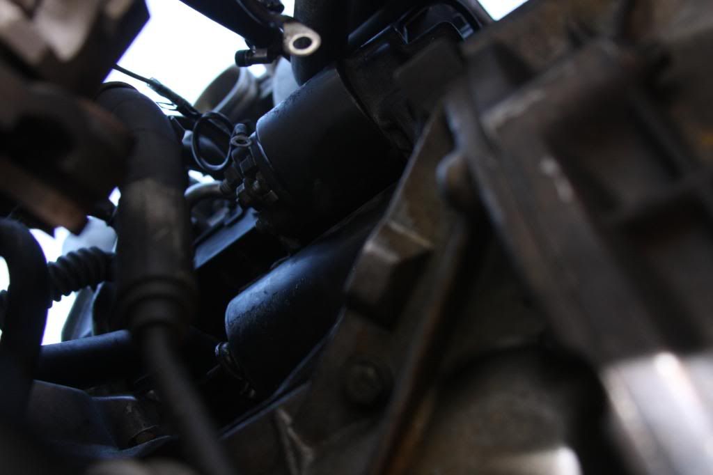

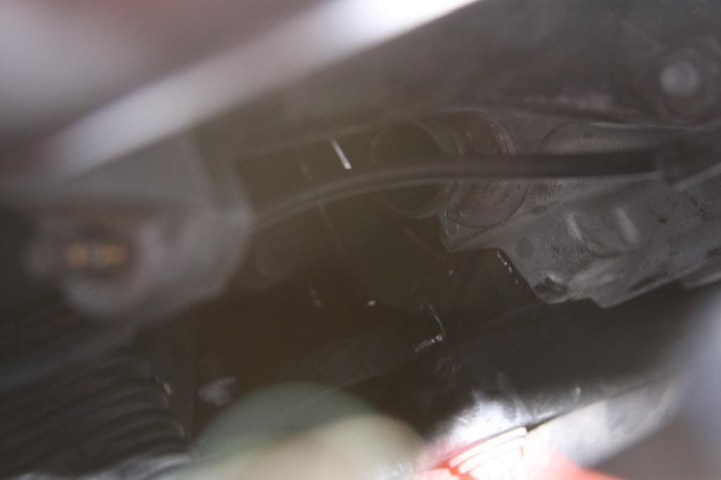

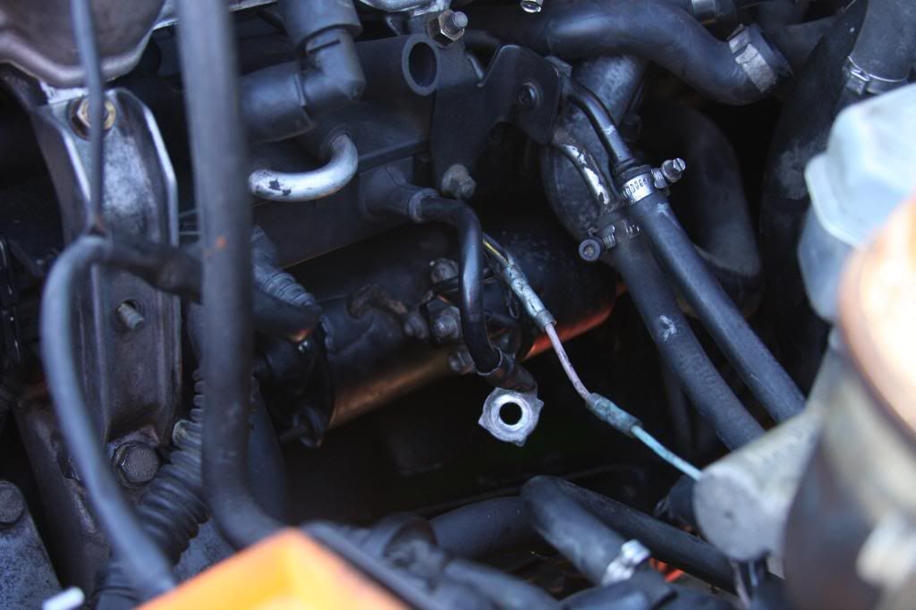

                        I can't get my starter out.
                        I've read three different tutorials that say three different things, I've tried all the shit it said and the fucking thing isn't budging. All say that there are a top and bottom bolt. There are two bolts on the right side of the starter. One is missing, was never there I guess. The other one that is towards the top I removed. There seems to be a third bold on the other side of the starter, but I can't get anything to turn it to even find out what happens if I could take it off. Nothing is moving at all as of now. I don't know what to do, if I pay someone to pull it and then it's not even the starter I'll just have wasted, idk, 300 bucks? FML
                        Here are some pics I took, hard to actually get any, but maybe you can use em to referance me spots.
                        Thanks to anyone who replies
                        Starter from far back
                        Where the bold I can't remove is
                        Starter from underneath
                        My camera's too big to fit underneath there.
                        • FredK
                          • 14762
                          There should be two large bolts holding the starter to the engine block, accessible from the transmission bell housing, while underneath the car and using a mega long set of extensions. They should be external torx bolts. On the other side of the bolts should be two hard-to-access nuts sandwiching the transmission bellhousing, the engine block, and the starter all together. I forgot, but if you can move the heater core hoses out of the way, you should be able to see these bolts.
                          There is also a sheetmetal bracket holding the starter to the side of the engine block. There should be a 17 mm head bolt holding the bracket to the block.
