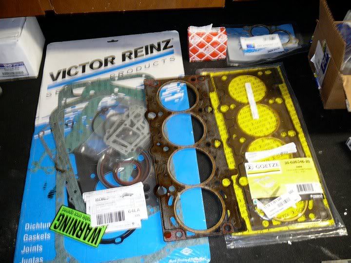

            this is the gasket i used on my M42, quite a few people said that this was the good gasket to go with, guess i lucked out...
            i think i got it from FCP groton. It's an OEM gasket. this was the first time the motor had received a new head gasket.
