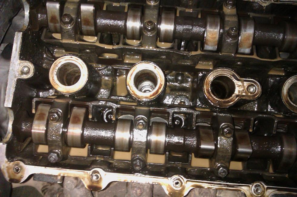

Just bought a 318is that pours white smoke.
    Pulled the V.Cover and found the MILKSHAKE!
    Spark #3 was covered in oil. the rest were washed in gas.
    pics in a bit when I get all this grease off

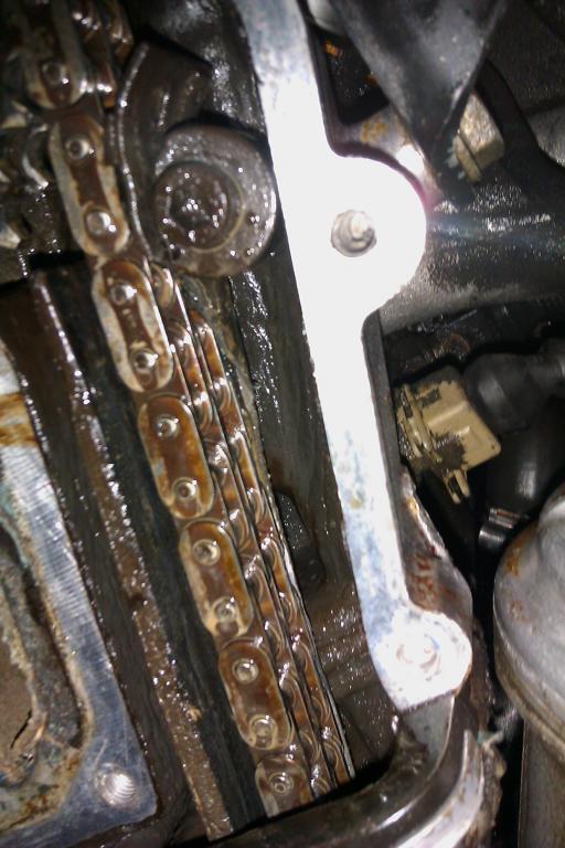

      Milkshake and timing case

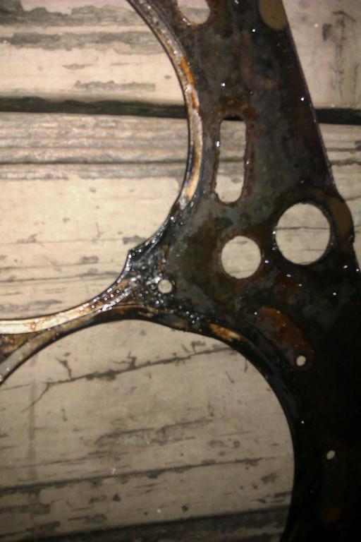

          Let the fun begin! I know how you feel, my M30 had a blown HG (missing about 1/2" of material) and head cracks @ #5 and #3. Not to mention the head was warped so badly it was junk. Had the curvature of a spoon.

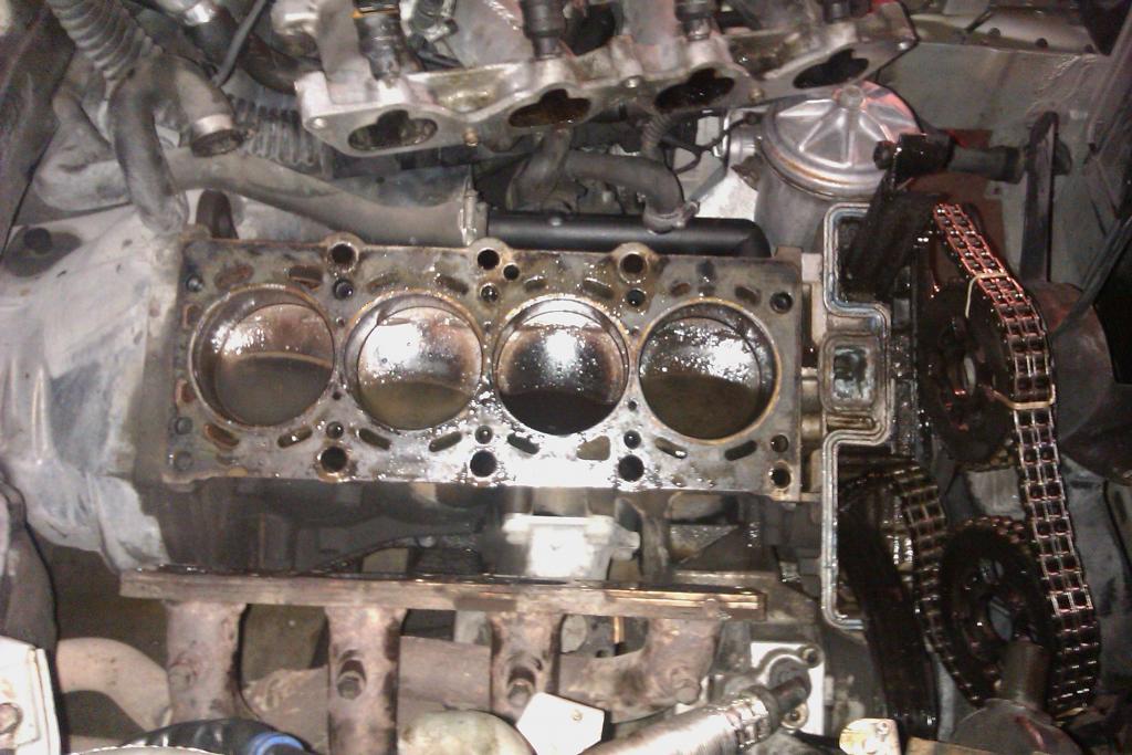

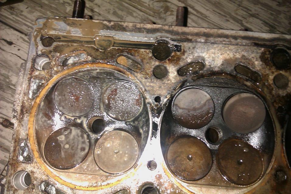

                Pulling the head off now, pics soon to follow.

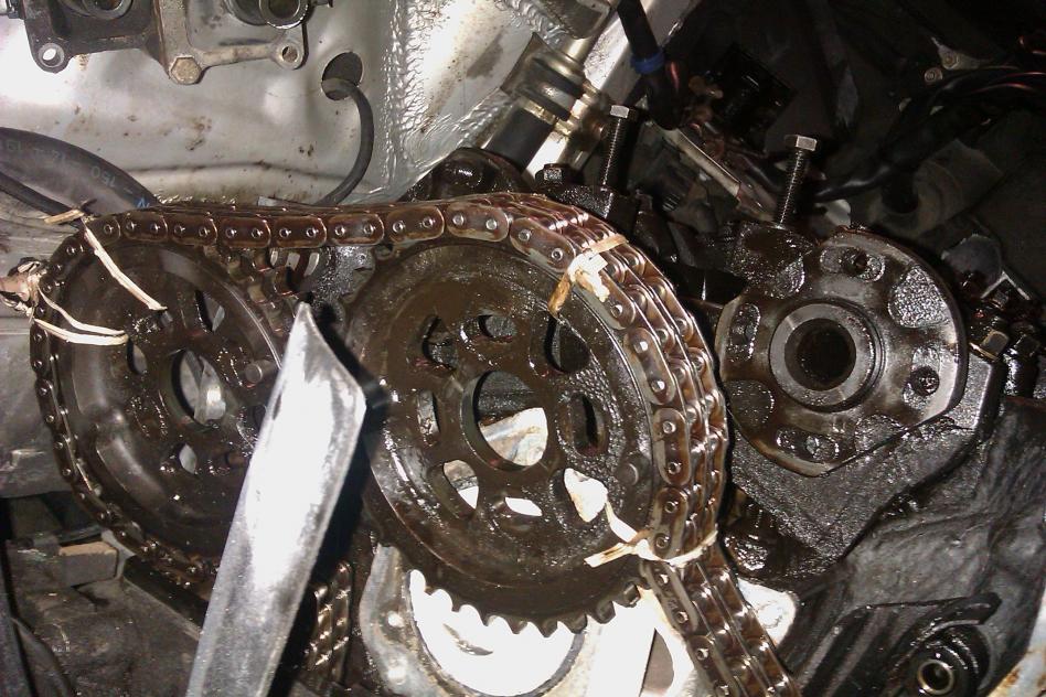

                  Now I wait till parts come in. Once I get everything back together I will post up pics and results. Hopefully this helps someone out there!A lil trick I learned to hold the cam gears to the chain. Really helps putting things back together

                    Pics no worky for me.
                      How about now?
                        Nope. The ones of the valve train work, the ones in post #23 don't so it's gotta be an error in the post and not my computer.
                          Update* fixed some pix
                            Holy cracknils Batman! Them's some pics!
                            I usually use zip-ties to hold my chains.
