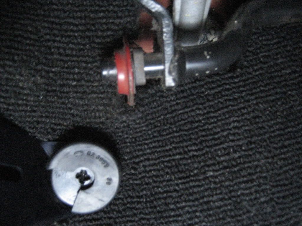

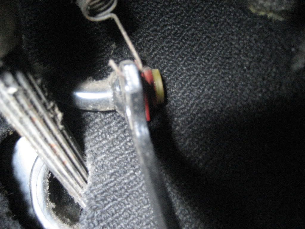

            Looking underneath today at the pedal area before adjusting the cable as sometimes, and rarely, it would still bind and get stuck. Taking a peek I found that the grommet for the return springs were missing but that shouldnt make it get stuck like I was experiencing. I then move the shaft that conencts the plate the pedal connects to and the plate the cable hook conencts to and noticed the bushing bearing is completely missing. The shaft has total play and the clipt to keep the busing from sliding is binding with the hole, and wala, pedal getting stuck. Ordered the $1.50 worth of grommets to solve my issue. Here is a picture of the right side above pedal, you can see bushing (yellow color) and the left side that is missing.
            Here is a pic of the new throttle cable. The design has changed and hard to tell in the picture. You don't need 2 wrenches anymore to adjust, just spind the finger grip to tighten or loosen cable. Also found out issue with stuck throttle, the shaft that connects the bracket to the pedal and bracket to the cable, has has the bushing bearing break off. It cause the shaft to move freeling and the clip to get got. Order the $1.50 grommets and bushing to fix the part of the car for the pedal area.
            Here is a picture of the left side and then the right side still with a bushing (yellow item).
