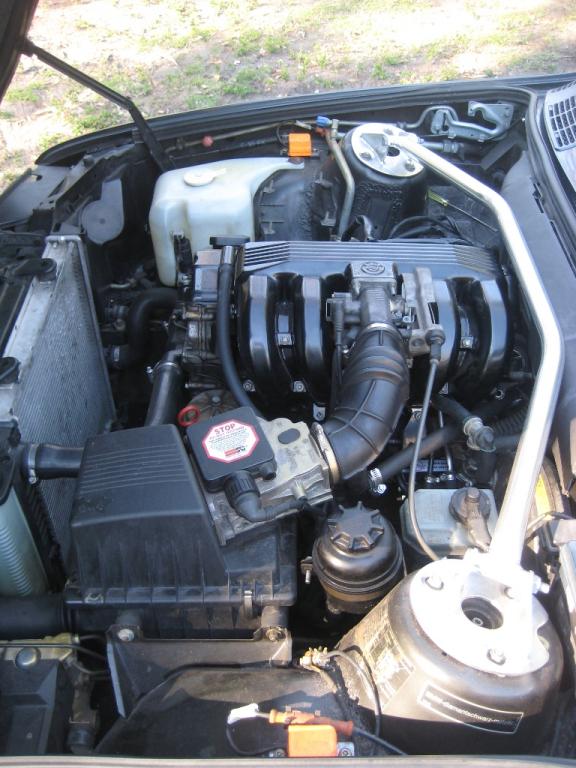

            where the wiring harness screws into the back of the afm there is a (maybe) foot long chunk of wiring harness that was a recall or tsb addition to fix some sort of idle problem. mine had it, I didn't know what it was and removed it. my car ran fine without it for a couple years. now that i'm having problems i can't find my old one too put back in.... was wondering if your car has it.... if not, it might be something to try. if it does have it...then never mind...
              Thanks for the info, but I don't think I have that. Here's a pic of my bay:
              My 1991 318is Progression Thread
              • snitzer
                • Jul 2008
                • 137
                #67
                the connector under your k&n sticker.... if you follow it back about a foot and there is another connector...that's the extension piece.... the tsb might have been serial number specific.... if you don't have the part, maybe there is someone near you that does and you can give it a try and see if it helps.... i'm barking up trees here...and trying to find one locally but have yet to find it.
