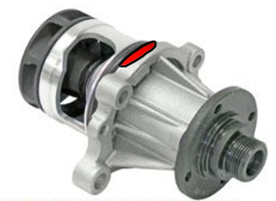

      Maybe a pic of the old water pump showing where the broken bit was would help.

              Thanks for the responses guys! I've been driving it (softly) around for the last few days, and it seems fine. I do think I may have heard a rattle when I was bleeding the coolant and had to rev up the engine - it sounded like something small was bouncing around somewhere in the block @ around 3000rpm. Below that, no sounds. Haven't heard it in the last couple days though.
              Sorry, I forgot to take pictures before I tossed the old unit - but here's a diagram of where it chipped. It's really just a chip that allowed coolant to get past the O-ring and leak out:

                I'd say that piece is laying on the road somewhere. The rattle you heard was probably the valves or timing chain.
                  This^^ + I don't think the piece you highlighted would be near enough to an open channels to go in... however, still possible. and it never hurts to drive responsibly
