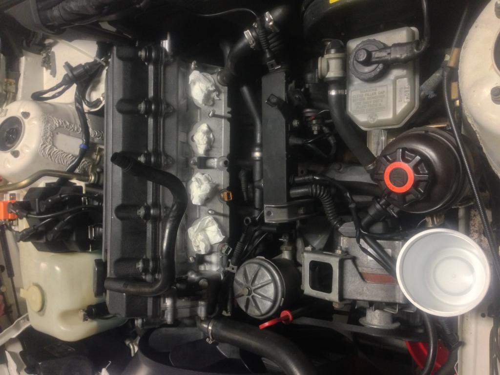

          #94
          Ok, so I went to attempt to tackle this today because I was going to do a black wrinkle finish on the manifold anyway and I figure while I was in there I decided to drop in the 19# 4 pintle injectors I got a while back (That's a whole other story, I had to make a thread about it.
          Once I got the upper off, I soon realized that someone has already tackled this, at least I think so. The TB heater plate was already deleted and the ICV hose was already routed the way it is in the diagram in the OP.
          Took a couple of pics for some confirmation:
          Before I touched anything
          The hose I'm pointing to goes from the intake tube to the ICV
          This one goes from the valve cover down under the manifold
          This is with the manifold off, still haven't removed any hoses or re-routed anything yet.
          Am I seeing things or is this the finished product??
          1991 318is - Daily/weekend track car.
          An on-ramp is a terrible thing to waste...
          • roguetoaster
            Biggus Tippus
            • 7830
            #95
            I cannot see under the lower manifold, so I am not sure what was done with the coolant lines or if the water pipe is newish, but the vac lines are routed correctly. Two things I do note, one is that your FPR line looks really past it and two, that line from the lower manifold to the brake booster is really awkward and would make me worry for some reason.

              #96
              The fuel line is still soft and easy to move, its not dry rotted or anything.
              The one on the booster was routed awkwardly...I fixed that.
              The coolant lines like like the diagram and look fairly new, I think it was done at some point in its life. Wish I had some records on this car!
