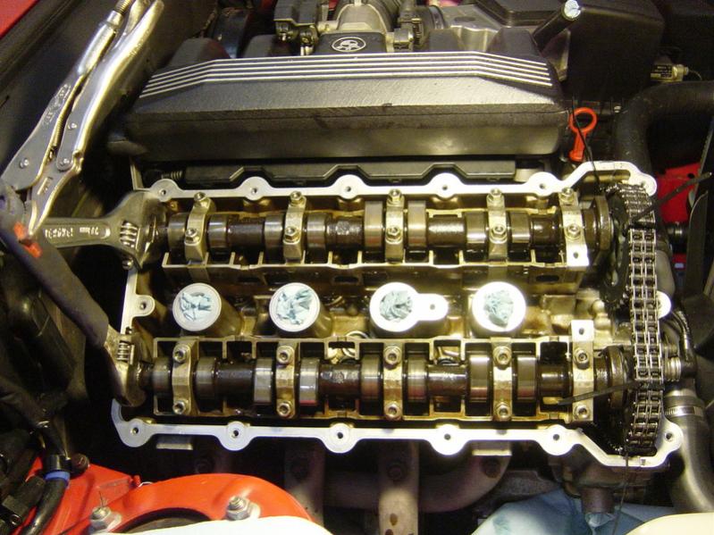

          Hey guys I just recently had my head resurfaced and opted for getting it rebuilt completely. When I got home I noticeed that the cams are not at TDC, I'm trying to figure out what is the best way to move them to get them at TDC?. Do I have to unbolt and place them correctly?

            BUMP, need some recomendation on how to get the fresh rebuilt head in TDC, the guys didnt set it and need some ideas on how to go about getting to TDC.

                But the head I still off the car, and i'm trying to figure out how to set it to TDC since the cams aren't facing each other... is there a way to rotate the top end while off the cylinder block to get it in TDC or do I have to remove the cams and set them in TDC? if so how. Thanks guys any info will help trying to get this done.

                • Ryann
                  • 3350
                  Do this. This picture is from this subforum.
                    Thanks alot this helped.
