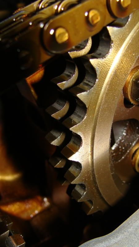

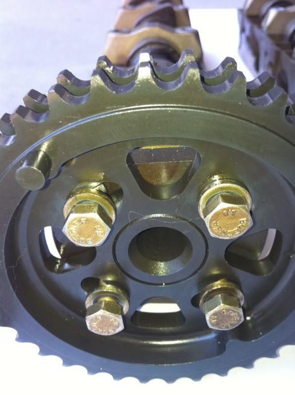

      Round/Square cam gear sprockets are good. You don't want pointy gears.
      Good
      Bad
