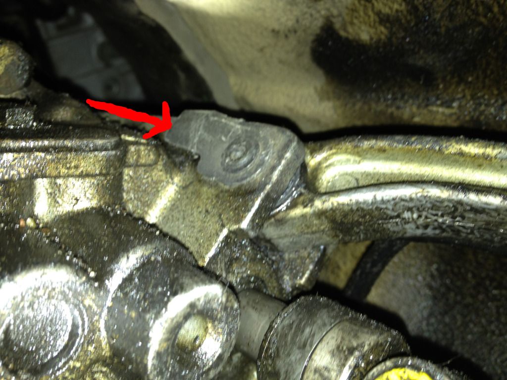

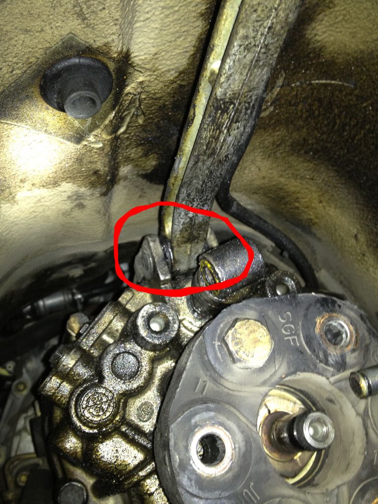

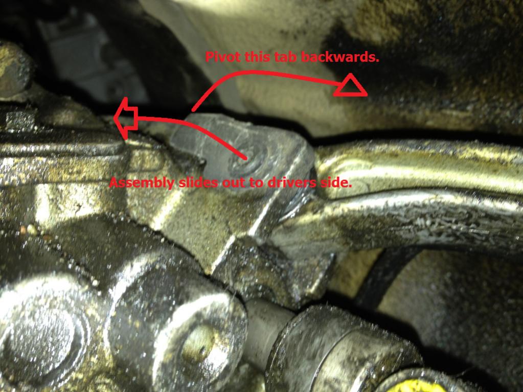

Any help on how to disconnect the aluminum shift console from the transmission would be greatly appreciated.
Trying to get the transmission off to replace my clutch and finally be able to drive this thing!
