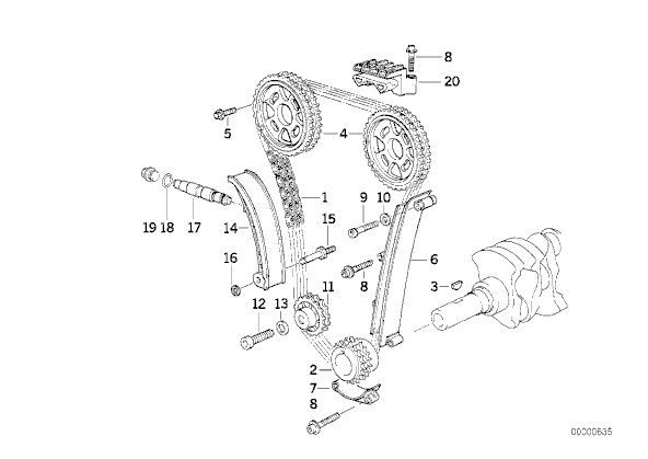

    my tensioner is on its way out and i hear that i can use a s50 or s52 tensioner to replace? is this true? thanks in advance

      OP this subject has been covered quite a bit in the r3v m42 subforum. A little searching and you'll find the info you need. You should consider pulling your valve cover and having a look at your cam gears and guides.
      The updated tensioner piston is #17 in the diagram below, BMW p.n. 11311743187
        appreciate the info... weekend project here i come.

              how can you tell when a tensioner is going bad
                Chain rattle at start up. The car will sound sort of like a diesel.
                The M42 tensioner has been updated to the M44 tensioner.
                Depending on mileage, you might need to replace the water pump and the chain guides.
                I replaced all the guides, the chain, the sprockets, tensioner etc. on mine at 155k due to the chain rattle mentioned above.
                But you might not need to go the whole nine yards. See if the new tensioner clears up the noise.
