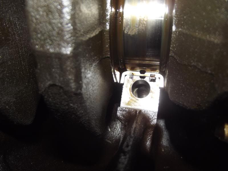

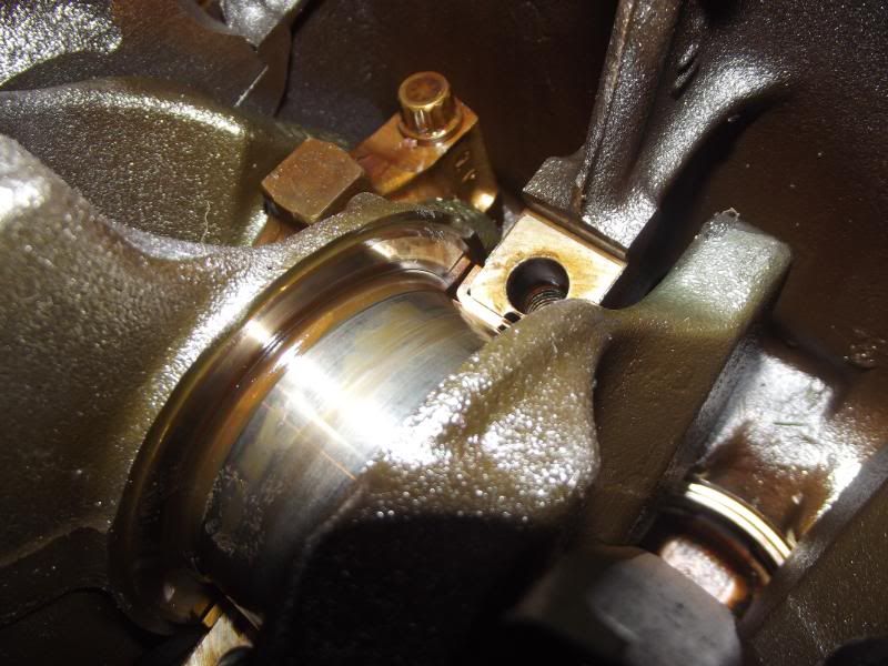

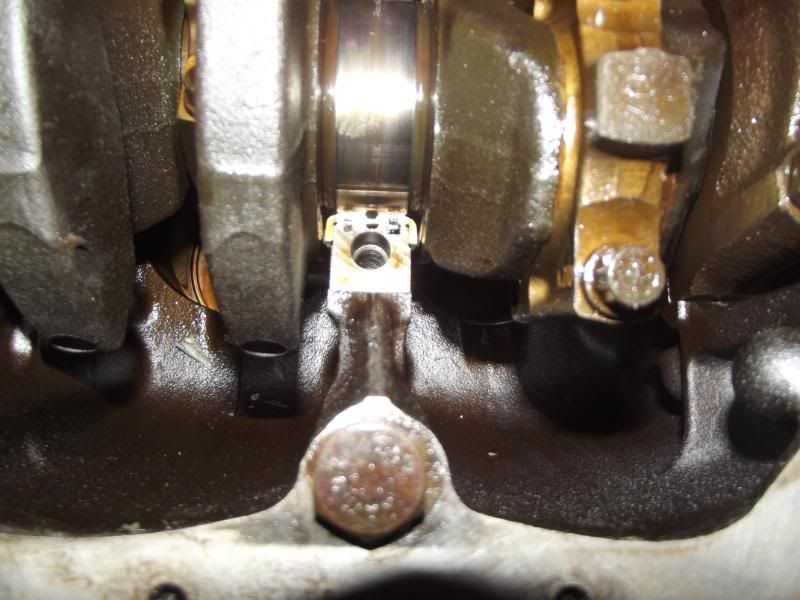

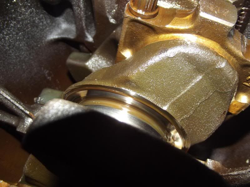

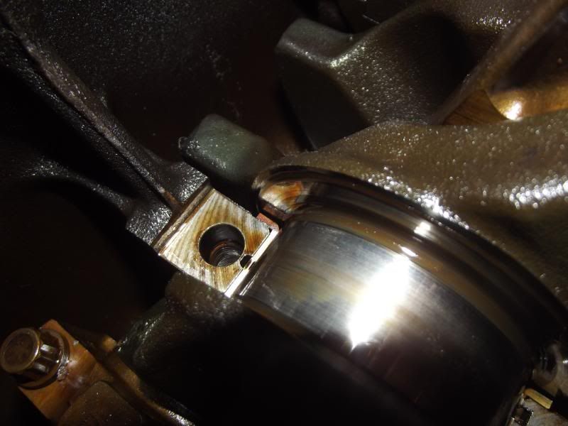

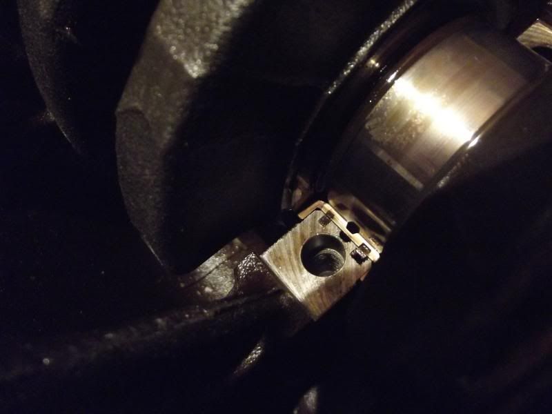

    Sooo this might help someone give me a clue on this:
    That's the #4 main/thrush bearing.

      This is a fairly common thing on M42's actually. It isn't GOOD, but it is common. I believe that later ones (and the M50) used a 360 degree thrust bearing and that it is like a direct swap for an older M42. Ask around on here and M42Club for details since I am not 100% sure.

          Per one of the original M42 gurus:
          Crankshaft : End play: 0.0031-0.0064"
          I'd guesstimate, from your pictures, that your crank has something like 0.025" of play in it.

            My engine had a bad thrust surface, got it welded and nitrided professionally with a 360deg bearing, and now the crank play is almost non existent and spins really really nicely.

              I would definitely order a new 360˚ thrust bearing for your engine. If you are patient and careful you can roll that one out and roll a new one in without pulling the crank. Either way it definitely needs to be done.

                  If you can feel/hear it, it's too much. Get a new set of bearings and hope for the best.
