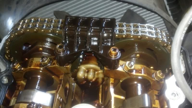

    1991 318i, 178k, recently purchased. Last night the car ran great for 9 miles, shut it down, started it up 15 minutes later, and it shakes very badly, sounds awful, hardly runs, but gets a little "better" over 3500rpm. Engine is missing significantly.
    Guy in my other thread suggested I pull the valve cover and see if my timing chain jumped a tooth. Well I pulled the valve cover off, everything to me looks clean and in good condition. The teeth don't show hardly any wear...
    I can wiggle the chain with my finger but not much. Another member said there should be arrows on the chain or sprockets that point to each other to tell you when the timing is on. Well I don't see any arrows or marks indicating where or what exactly needs to line up.
    Here are the pictures:
    What do you think???

    The teeth look good the sprockets... doesn't mean that the guides are in great shape though.

      So now what do I do?? How can I check to make sure the timing is correct?
      What else could make the engine go from running great to awful?
      There are no stored engine codes. All the spark plugs look good. Also despite it running like crap, the timing chain didn't appear to be making any noise??

          Timing on the M42 is verified in 2 ways, if both line up timing is good, the only reasonable adjustment you can make is to the cams. Cams, when the rear square sections are flat (use a straight edge across them) and the front two lobes point up and at each other like / \. Crank, when the arrow on the block points to the window (missing area or teeth) on the crank sprocket/vibration dampener. Start by rotating the engine to TDC at the crank, then lock the flywheel (with an 8?mm device, like a drill bit), then look at your cam timing, adjust by rotating the cams.
          Hard to know why the car is running poorly now, was it sitting for a long time before you drove it?

            To add, if you want to check to see if your guides are good, you either need to pull the upper timing cover (best) or remove the lower pan and look for bits of plastic. I would think that your guides are in good shape as your cam gear teeth look fairly square. My bet for bad running is a bad coil/driver or bad fuel/fuel shortage.

              the engine didnt jump time. op dont waste youre time checking timing. thats not the issue here.
              Check engine managent things first. just cause you have no mature codes doesnt mean you crank sensor isnt shitting out.

                I found the problem. The number 4 spark plug cylinder gasket failed and puked a bunch of oil up into the spark plug tube that goes between the wire and the plug...
