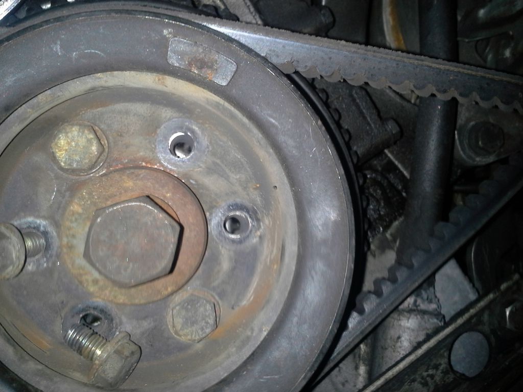

wtf is wrong with my m42

        i doubt this is the issue considering the car ran fine before. Banking on possible crank sensor shitting out. Weird things happen when they start malfunctioning. Cam sensor too.

          my car had a similar issue except a lot worse, I replaced all the vac lines and icv to no avail. So got it smoke tested, turns out there was an small intermittent leak in the top intake manifold gasket. Not sure if this helps, but i would suggest checking the gasket out as it seems be due to the cold weather.

              Coils aren't the issue........vac reading at idle is 17.5.......takes a huge dump with any accel......ideas

                Well, vac leak, either something is expanding, one of your plastic connectors is cracked, the plug in the intake boot is coming out/intake boot is cracked in an odd place, intake manifold gasket is dying, or the FPR hose has come off.

                  Issue solved pics to come

                      So, was timing off, or was the entire crank pulley just coming off, causing a bad crank position sensor read? If the latter I suppose proper torquing is important.
                      Glad you have found the problem!

                        oh shit lol

                          Lol yup good thing its a quick easy fix

                            Haha Fil! I called it.
