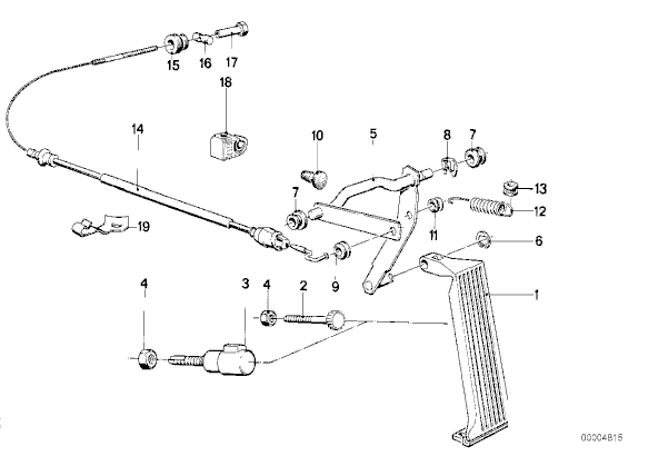

    last issue I had to install a new throttle cable because the old one was broken. there was an adjustment screw on the end that I lost. The new cable has some slack to it and the adjustment screw would fix that.
    Its #17 anyone have a part #

            Thats not the correct throttle cable for M42, the TB end should be a crimped fitting.

              My battery is in the trunk and the battery is brand new . I tested the voltage on the starter by the positive terminal and a ground not the junction box on the firewall. I will check the junction box voltage soon. As far as the fuel pressure, I get nothing out of the return line. I also deadheaded the intake line and still got less than 10 psi. This was after the fuel filter, I doubt the fuel filter is that clogged but I will test before the filter, before I order the walbro pump and skip another cheap autozone pump. The throttle cable has a crimp on the end that looks like the kind on the end of a bicycle brake line. The problem is that it is too long. The gas pedal is half way to the floor before the throttle body valves even move. Is there any way I could adjust the pedal?

                For the cable being too long, shorten the cable jacket adjuster at the throttle body all the way, pull the extra cable through to get your pedal all the way up, cut the crimped end off, use a crimp on for 16/18 ga. electrical wire to replace the one you cut off.
                Leave a little slack between the crimp on and the piece the cable runs through (1/8") Adjust cable to get W.O.T. but not tension the throttle linkage.
                I did this when using a throttle cable from an E36 M42. 4rys no issues.

                  You sure you don't have the throttle cable in the location on the lever that is reserved for the cruise control cable?
